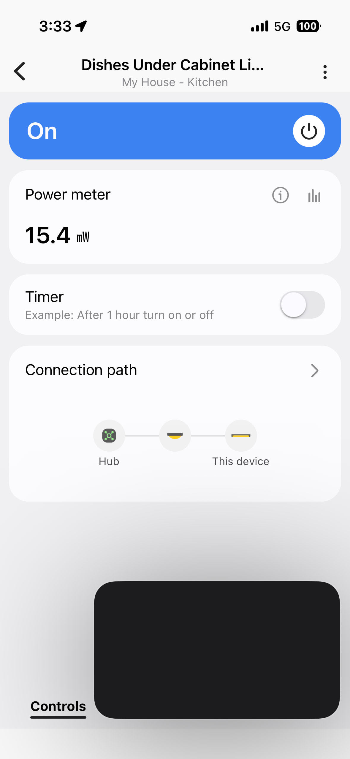

Zigbee jasco plug 45853
Units should be watts, not mw.
I would suggest trying the “ZigBee Switch Power Mc” driver. I don’t know if the fingerprints for your plug are in that driver, so it may not work.
If the power display is still wrong using that driver you can go into settings and make the needed adjustments.
I get no other options for diver. I don’t know why there isn’t options in settings for units for all plugs and switches.
Is the ZigBee Switch Power Mc” driver the installed on your hub?
No, I only have stock devices driver. What’s the repo for that driver?
Installed MC driver and enabled zigbee switch and zigbee switch with power. But divers don’t have correct fingerprints so can’t select a different driver.
If you post the fingerprint here, @Mariano_Colmenarejo might add it to the driver (he isn’t as active as previously). Otherwise, you’ll need to clone his repo, add the fingerprint, and build the driver yourself.
