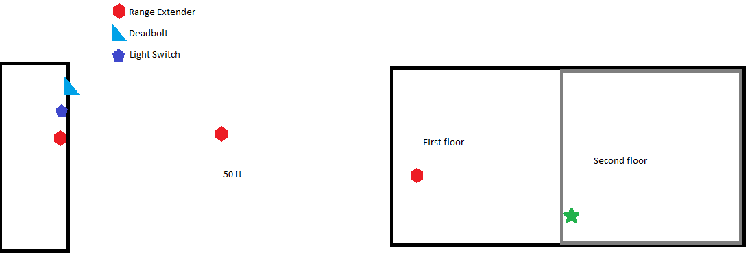

In case it helps, here is a diagram of the layout (green star is my SmartThings hub, upstairs in my office):
Zwave is a wireless mesh network. It’s just a wireless mesh network with a limit of four hops per message. :blush:
The Zigbee profile that smartthings uses has a hop limit also, but it’s 15 hops into the hub and 15 hops out. However, each hop is shorter than a Z wave hop.
First steps I would do:
Get rid of the range extender that is inside the garage. Then run a zwave repair and show us what error messages you get.

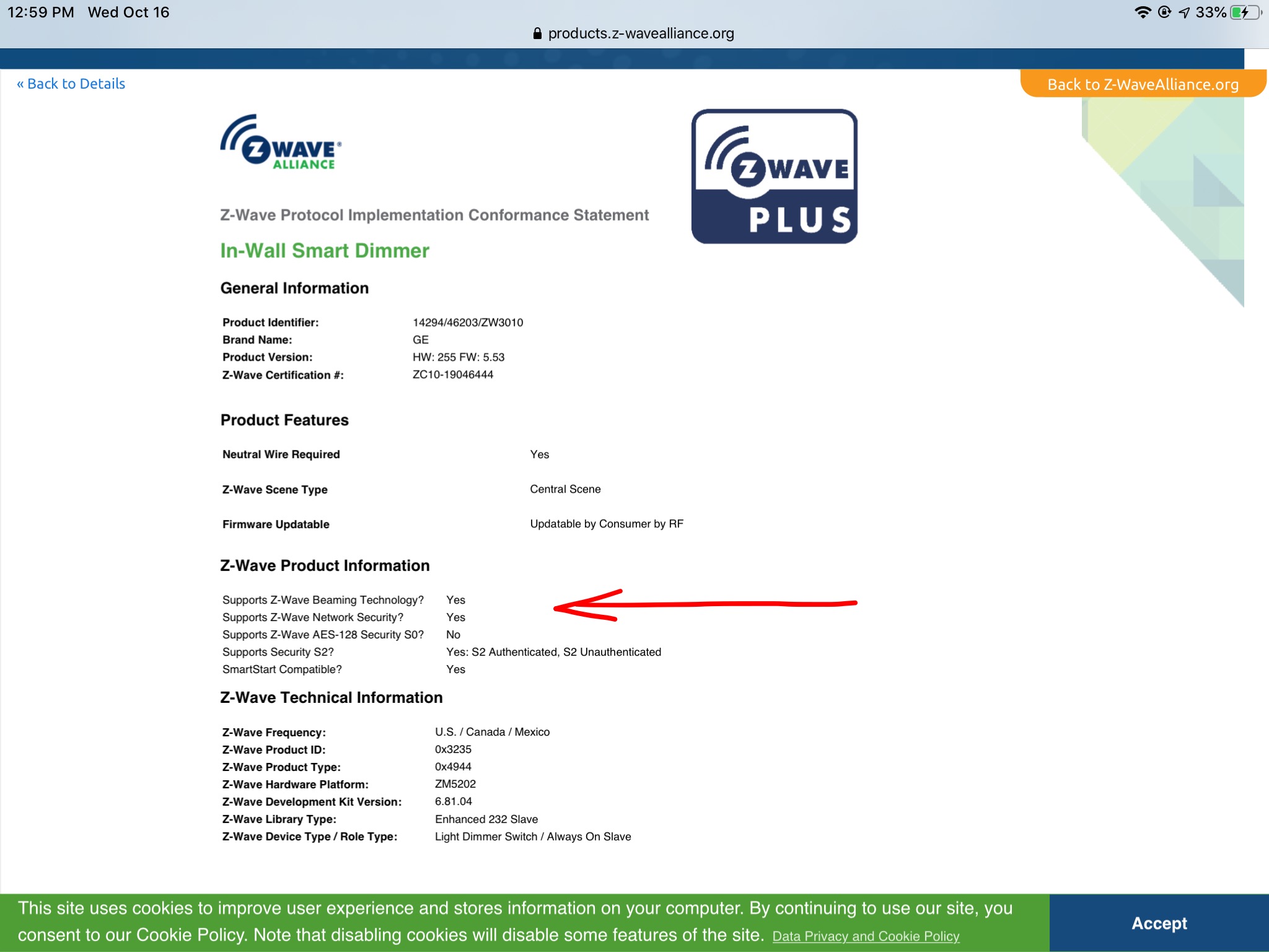

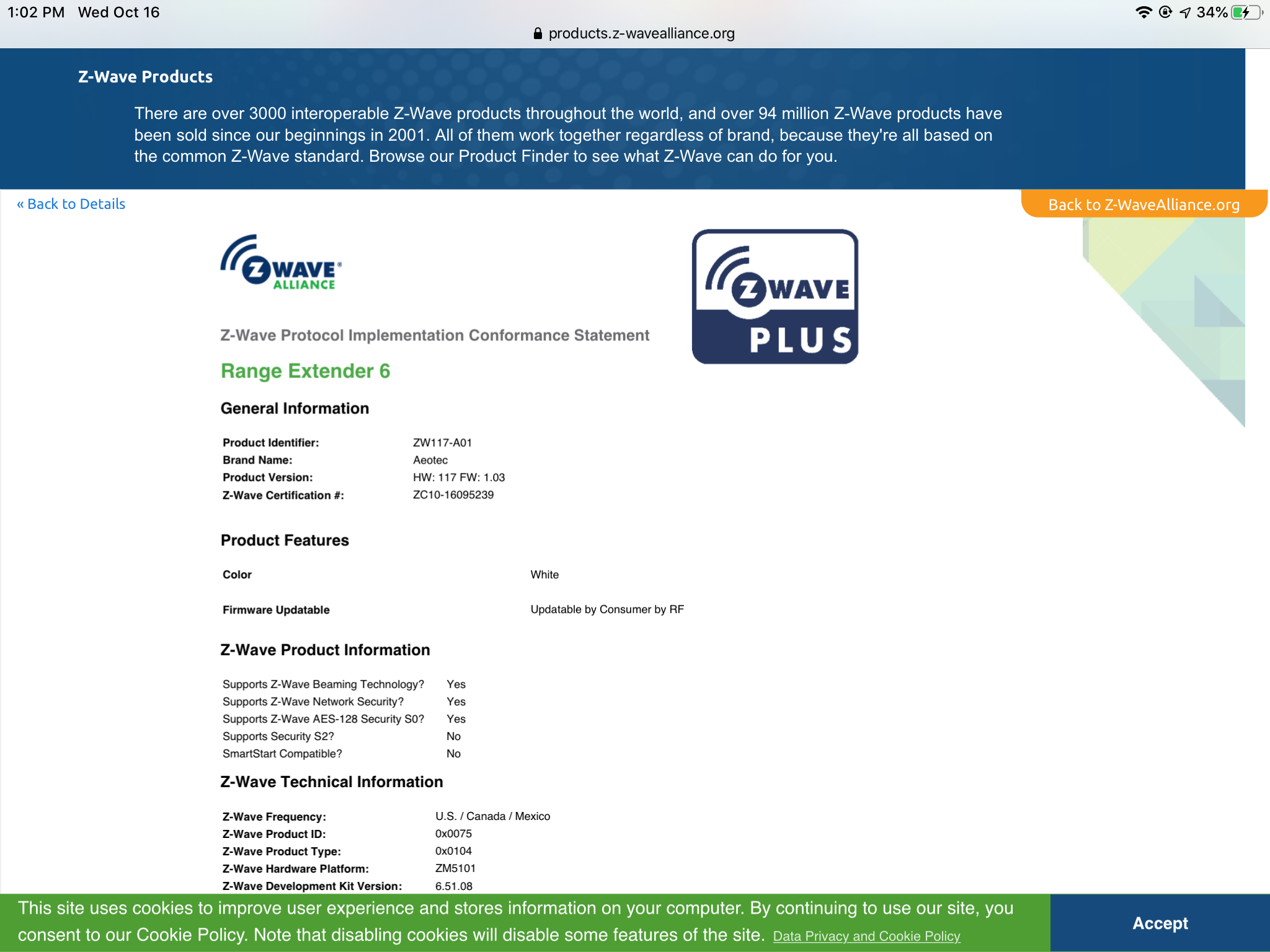

Couple questions / suggestions, when you mention zwave repeaters do they support beaming? And the new GE switch, is it zwave plus and does it support beaming?
Other suggestions, draw a complete map and list of your devices and consider options to relocate the hub and powered zwave devices to optimize the mesh.
Yes, both device models the OP mentioned support beaming.

Physically move the kitchen range extender into the same room as the hub, then run the repair again.
BTW, your first post said the FAQ doesn’t explain the error message
But it does, in post 25.
Since the kitchen repeater did not report its neighbors, we have to get that fixed before we go any further.
So we are physically moving that device to see if the issue is the range to that device, or if it’s something else. :sunglasses:
(BTW, kitchens and garages are almost always the toughest rooms to get signal in and out of, except basements. Lots of big metal objects, frequently water pipes in the wall, sometimes ceramics. It can get tricky. Absent installer tools which smartthings does not give us, it often just takes trial and error to get the device locations right.)

It looks like a range issue. You weren’t getting signal down to the kitchen, so you weren’t getting signal from there out to the outbuilding.
The kitchen extender was fine once you put it in the room with the hub.
Is there a room Other than kitchen on the same side of the house as the garage that you could move the kitchen extender to? (Like I said, kitchens are often problematic.) preferably with a window?
Our next goal is to move the kitchen extender someplace inside the main house where we have good communications with the hub and then see if we can get a good connection to the yard extender from that. We’re not going worry about the garage switch or the garage lock yet. we just want hub to kitchen extender to yard to be clean first.
