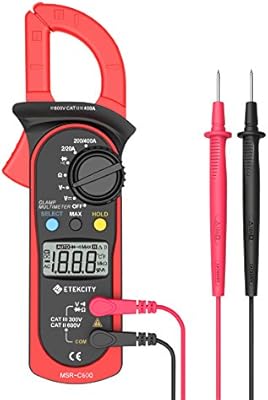

You can get a $25 clamp meter that isn’t networked to anything and use it to test your individual appliances to make sure that they are operating at the rated level. But that may be more effort than you want to put in.
