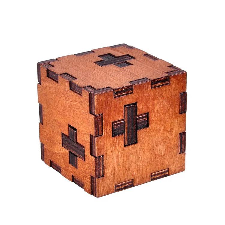

This is a SmartSensor MutliSensor stuck to a wooden box. Just need to add stickets now.
The magic is done by the smartapps and allow you to trigger routines when:
You change the orientation of the cube
When it leave or return to it’s home location (with a magnet well positioned to trigger the open/close contact).

Take any pictures while you were building you want to share? Would love to see how you made the wood cube (selfishly as I want to build one now!!)
Got from a wooden puzzle.

Someone knows where to find a nice box for this? Like that puzzle box
Ac7ss
(Glenn Brockett)
October 13, 2016, 3:30am
15
I use the Photo Cube . try the craft stores for local ones. Also the Baseball holder looks like it would work well.
