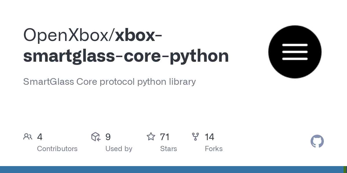

Here , I found a complete python library for various control of Xbox:
But I really don’t understand python, specially the way the IP package is formatted.
Can anyone help me figure out which package should be sent for power off ?
Here are what I have found out in the code to turn off :
def power_off(self, liveid):
    Power off console
    Args:
        liveid (str): Live ID of console
    Returns: None
    msg = factory.power_off(liveid)
    self.send_message(msg)
factory:
CHANNEL_CORE=0
def power_off(liveid, **kwargs):
Assemble PowerOff message.
Args:
    liveid (str): Live ID of console.
Returns:
    :class:`XStructObj`: Instance of :class:`:class:`XStructObj``.
return message.struct(
    header=_message_header(
        MessageType.PowerOff, CHANNEL_CORE, **kwargs
    protected_payload=message.power_off(
        liveid=liveid
message:
power_off = XStruct(
'liveid' / SGString()
XSrtuct is found under xbox/sg/utils/
I’d really appreciate if someone can help me to form the correct packet for power off.
