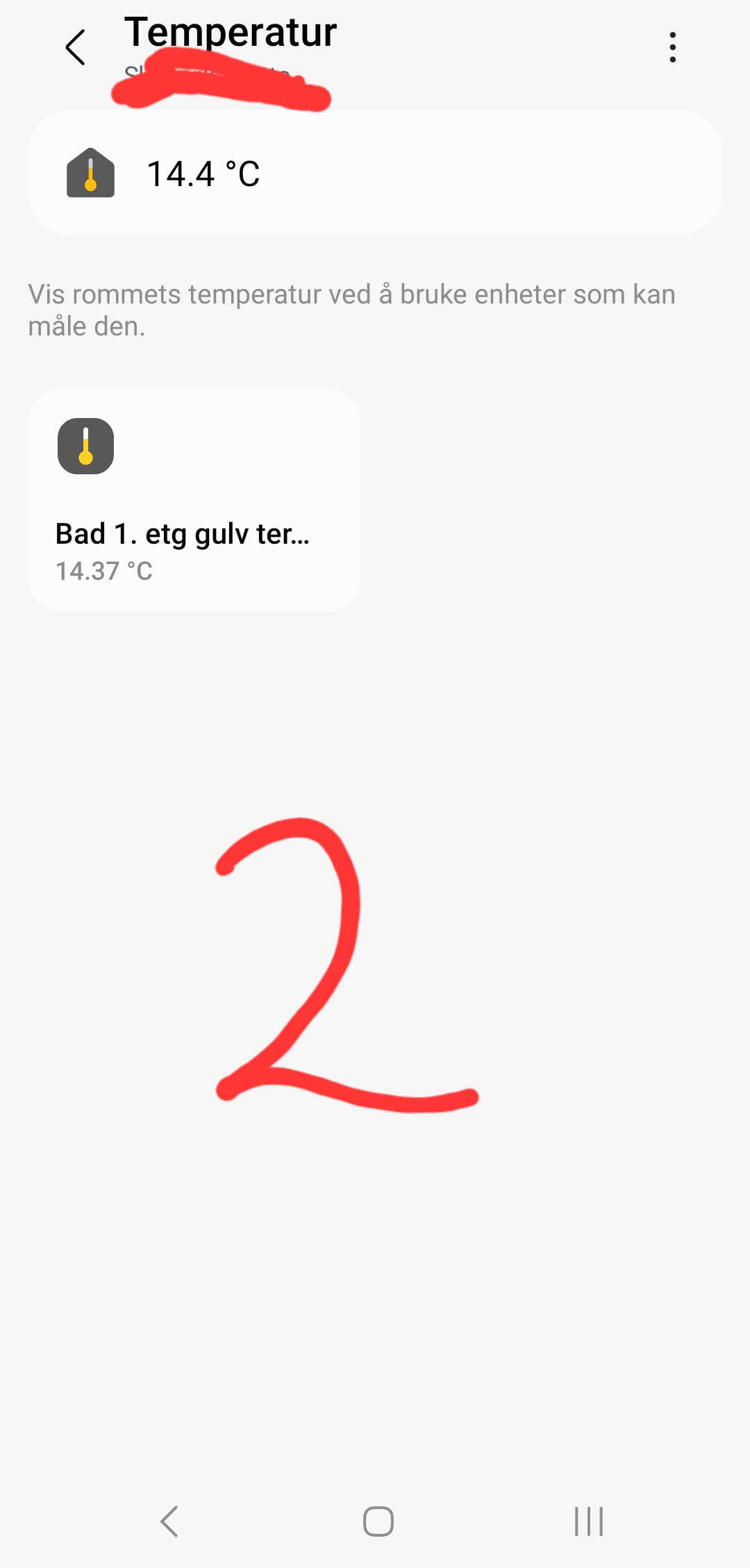

The mini tile reading is obviously in error (the temperatures in the
room and device views are physically correct)
1 Room view
2 Mini-tile view
3 Device view
4 Device view continued
