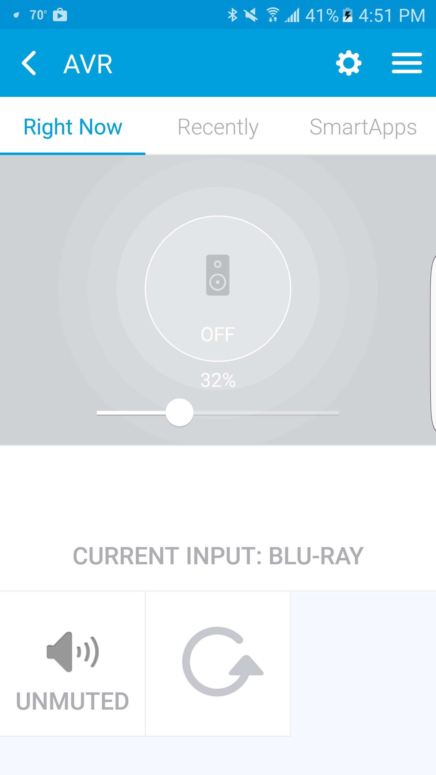

Ok, I’ve updated the github to what I currently have. You may need to change the input names to better suit your needs…
grab it from post 108:
Awesome thanks, strangely this handler broke compatibility with my s910w, which is very similar to the 710w you use to test. None of the input selections work, it appears the pause/play power functions were the only things working. Reverting back to your last handler until I can take a deeper look
Sorry about that, It’s very strange…I didn’t change the commands sent to the AVR, are you sure you were using my handler and not some other version?
Yeah positive, right now I have both handlers installed to swap between. I’ll look more at it tonight, strange
Hi Bobby,
would love if you can give me a quick instruction on how to get this whole Denon network AVR setup.
I’m pretty new to all of this ST.
I have copied your code and created a new device handler. What will I have to do next? Is there a shared code to create a smartapp? TIA
Short answer? All you have to do, is use it :grinning:
Longer answer, you can use the device directly as volume control. So if you add it to any apps that control dimers, you can set your AVR to a specific level. For using the other inputs, you need an app like CoRE. There is no specific app to make use of your new device. The device is fully operational.
