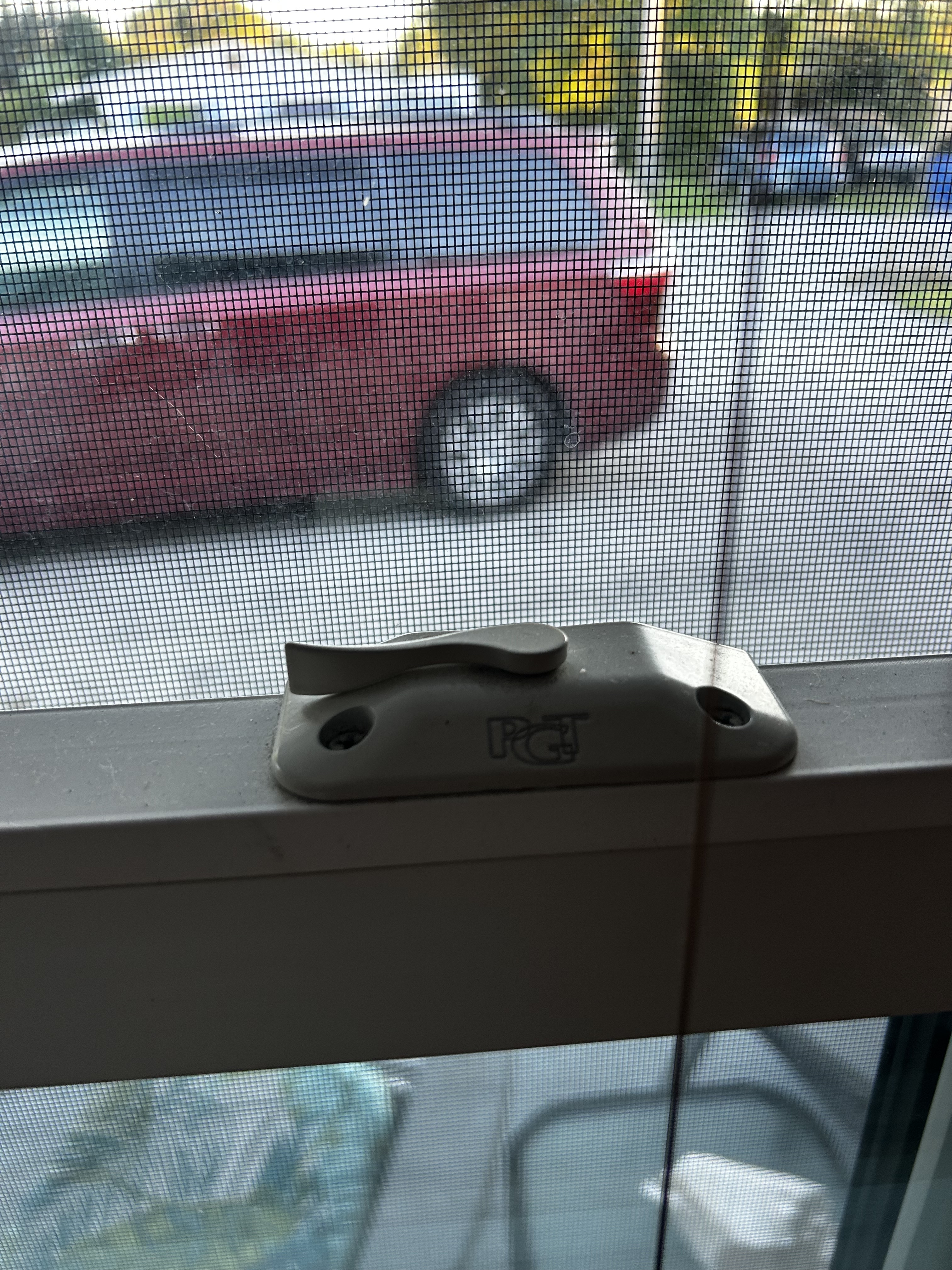

Can you post a picture of the window latch so we can see the exact mechanism?

Do you need it to be a simple state test of “is my window lock latched”? For example, I’ll assume that the lever pointing to the left is “latched” and any other position is “unlatched”?
Actually that window is open/unlatched, but you get the idea, I want to be able to tell which windows are latched or unlatched . Here’s another example
A contact sensor could do the trick, but it’s a matter of finding one with a small enough magnet and how to attach it to the lever. Might be a bit unsightly however.
The Aeotec door and window sensor 7 and 7 Pro have a really small magnet portion (0.31" x 0.78" x 0.43") that you might be able to somehow mount on the lever. https://aeotec.com/products/aeotec-door-window-sensor-7/
