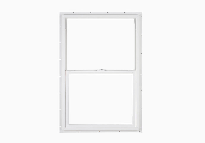

Can you post a picture? People have done this kind of thing a couple of different ways, but it depends on the exact geometry.
Posting a stock photo but I guess it’s termed a sash lock, there are two per window for our setup, at about the 20 and 80 percent mark. You flip them left to unlock and right to lock
