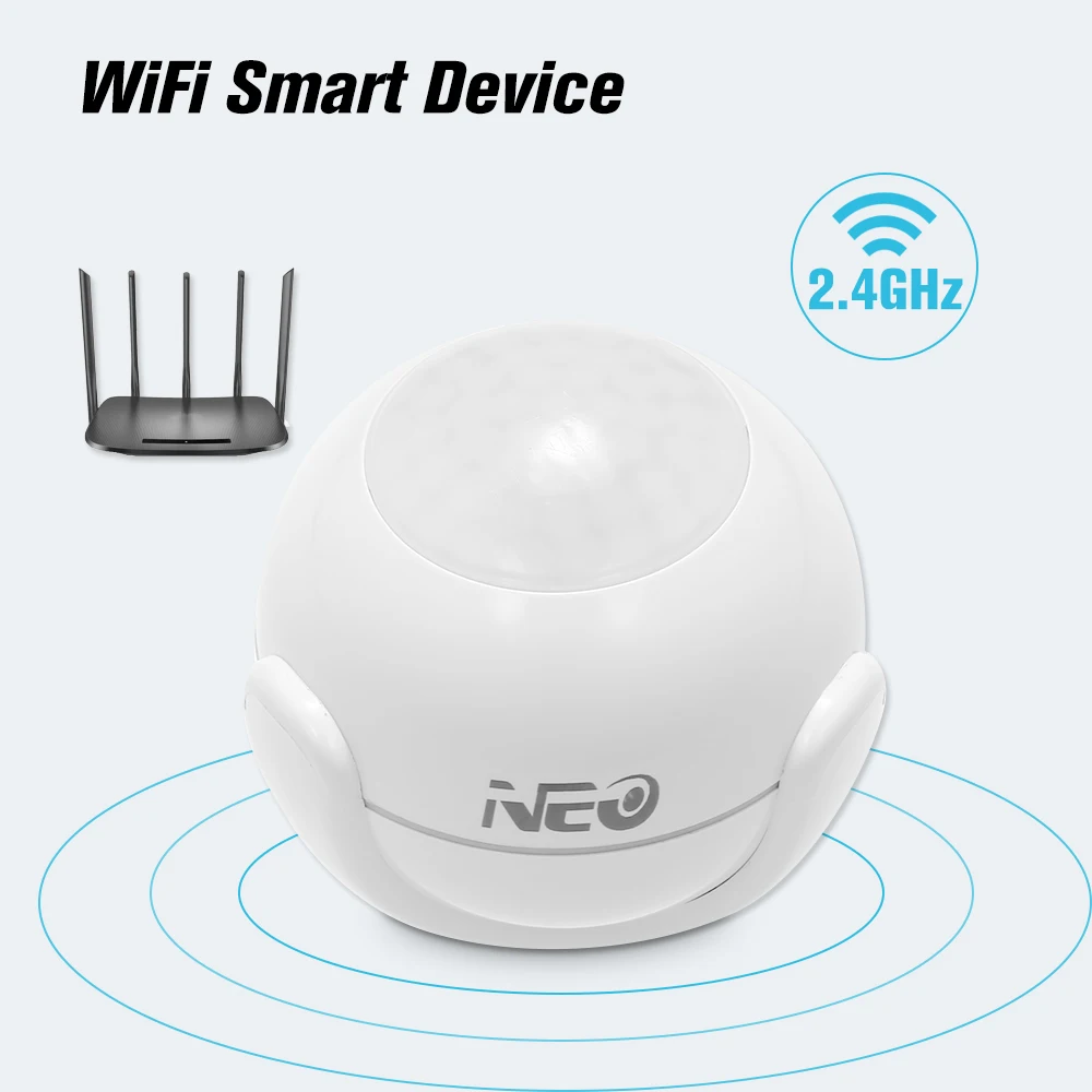

There are WiFi motion sensors, I had one of these for a while to experiment with:
It operates on the Tuya platform and i think works with IFTTT. I got it because we’re starting to stock a range of WiFi products at work based on the Tuya platform. I found that wven when being used to control lights on the same platform, without using the IFTTT integration it was slow to respond, with a delay between 5 and 10 seconds to activate a light. I put the delay down to it having to connect to the wifi every time it woke up and that taking some time. I ended up giving it away because of the lag. You may find a mains powered wifi sensor will improve that but since you’ll still have to use IFTTT and will therefore have variable lag that may or may not work for you. If it’s just for an alarm, fine, if you want to automate lighting I doubt it will respond quickly enough.
Normally WiFi devices don’t sleep (it’s one of the things that makes them go through batteries so quickly). You’re definitely right that if that particular brand has been engineered to sleep, re-connecting to the network every time it wakes up will add noticeable lag.
Zigbee and zwave battery-operated devices typically don’t have that issue because they don’t have to go through a rejoin process after they sleep. (Although the devices that also get moved around physically like handheld remotes may have to find new neighbors if they’ve been moved to a new location, but that’s still faster than a network rejoin.)
I did notice recently about a dozen Wi-Fi battery operated sensors, all from the same factory, in the coolcam design, all using the Tuya or Smart Life app. It looks like they are intended for the Amazon Echo market, but the ratings are pretty uniformly abysmal, as opposed to the few that appear to have been designed independently for Wi-Fi.
The unacceptable ones are also using the same small cases and the same small batteries that zigbee ones from the same factory use.
The Wi-Fi sensors that were designed from the beginning for Wi-Fi tend to have much larger cases and use at least three AA batteries. They are discussed in the wiki article.
So I suspect your experience was pretty typical with the small ones, regardless of brand. :disappointed_relieved:
The one I had was tiny, and had a very small battery that was still going after 3-4 months when I gave it away, which is what makes me think it was going to sleep between detections. It actually worked quite well, and I’d have found a use for it had it not been for the lag.
Oh, actually, another downside was that it was 2.4ghz wifi only, and (as with all tuya devices so far that i’ve tried) could be a bit fiddly to set up if you had 2.4 and 5ghz networks sharing the same ssid - my phone had a preference for the 5ghz, no means of manually changing to 2.4, and the app used the network the phone was connected to so…
