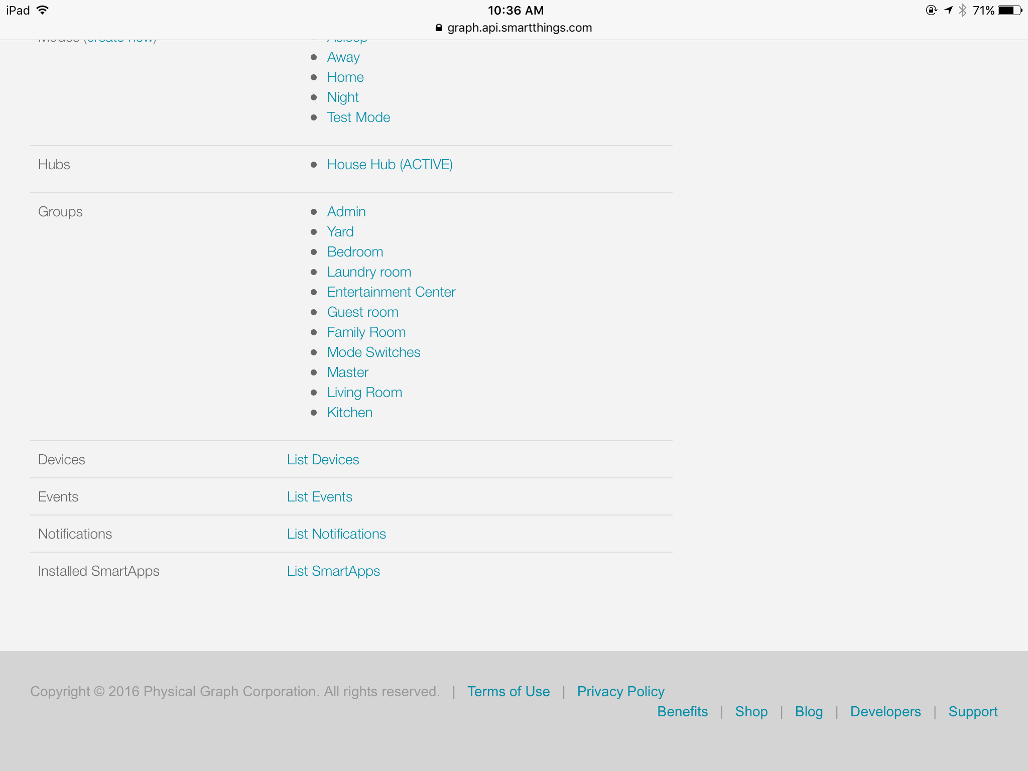

I’ve installed another smartapp, “smart lighting” now on the iOS app. However if I goto my computer and look at the IDE (UK), and look at the the smart app header it only lists Rule machine and Rule. It doesn’t show Smart Lighting, ant reason why?
The IDE smartapp section only shows smartapps you add in the IDE smartapp section. Since Smart lighting is published and not installed this way, it does not show up. What is your intended purpose to see it?

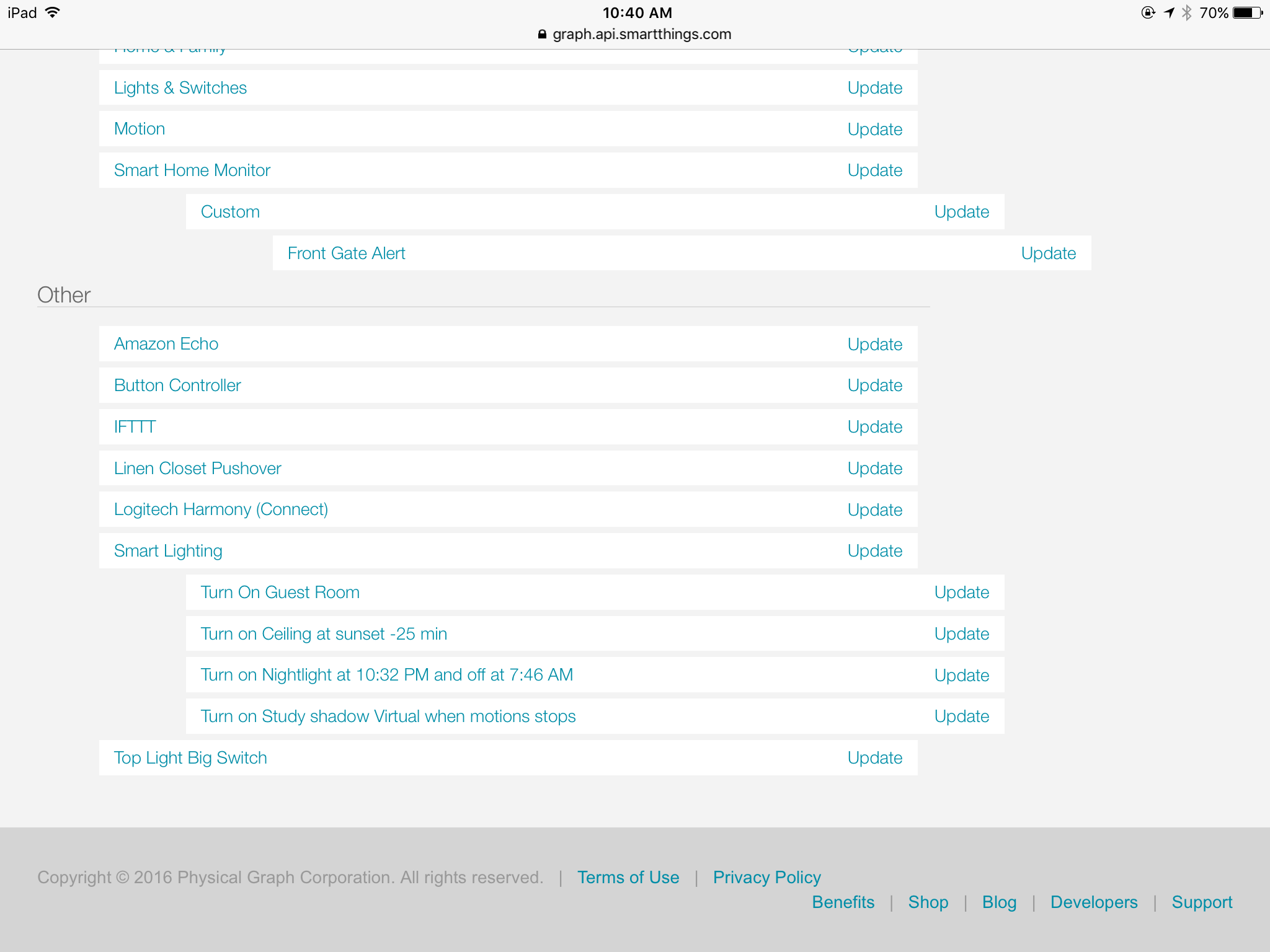

Four) now you will see all your routines and installed solutions, like smart lighting. Look all the way down at the bottom under “other” and you will see each smart lighting automation that you have created.
