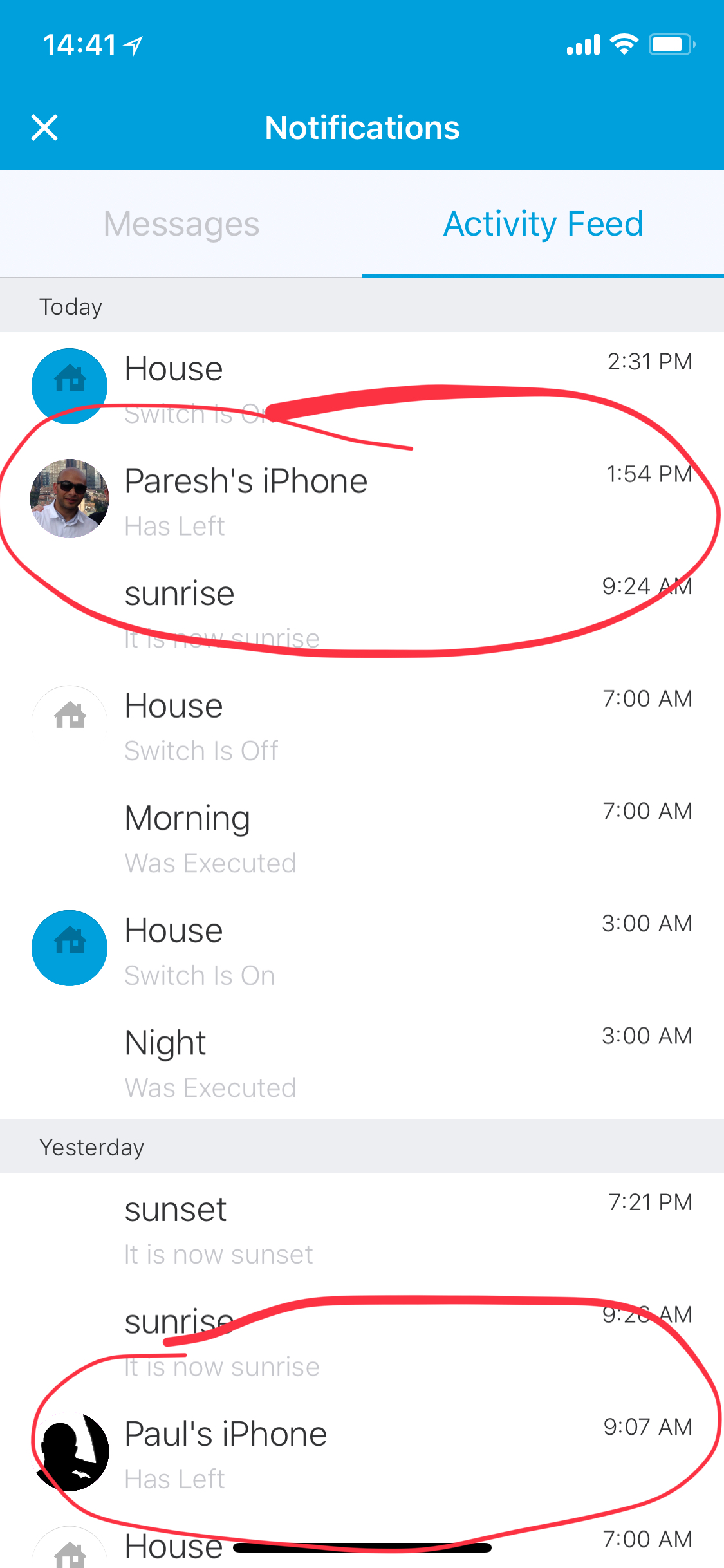

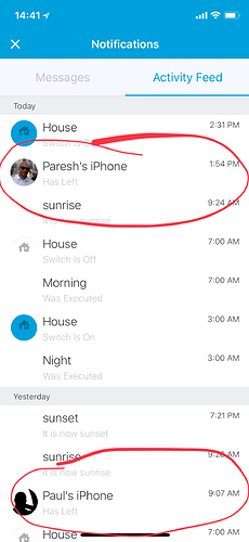

I left home yesterday and when I look in the SmartThings app I can see I’m away and the other device is present.
Today the other person left home and the app shows both of us away however the rule didn’t trigger. If I look in notifications/activity it shows me leaving yesterday and the other person leaving today.
Consequently nobody at home and no Blink system armed until I manually turned it on.

The phone has to have an internet connection to register as present or not. I suspect that when it didn’t run phone #1 had gone from Not Present to Unknown.
Well, it’s a cloud device, which means the processing doesn’t happen on your hub. The phone updates it’d location which triggers ST to set the device to not present. Then when ST sees its not present for 10 continuous minutes it triggers the routine. So if the device goes to unknown during that 10 mins it won’t trigger. But if it was away, it should stay away even if you temporarily lose internet on your phone.

That’s not how smartthings works. Also, it doesn’t matter what your phone does, it matters what the device’s status in ST is. When i lose internet on my phone it keeps the current status (present or not present) permanently until the phone gets connection again. Also, do you have the routine set to execute only once per day? That might cause things to not carry on between the two days. Basically, if all your presence sensors show up in ST as “Not present” for 10 minutes the routine should trigger. Have you defined your home boundaries also? Remember, it’s not when you leave, it’s when ST recognizes that you’ve left. So, your ST app on your phone has to send a message to the ST cloud to change your device. So, unless you have location services on on your phone, it won’t update your device’s status in ST.
