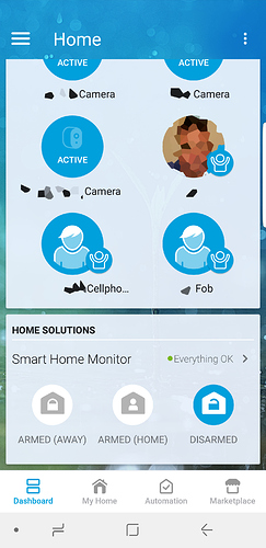

Here is a picture of the screen I was referring to. Notice my favorites I put on there there are three that I think may affect my geofence.
I know the “Cellphone” is my cellphone
I know the “Fob” is the fob on my keychain
But what is the one with the picture of myself? I put that picture on there I know that but that is a person. How does a person differ than a fob or a cellphone as far as running routines and modes?

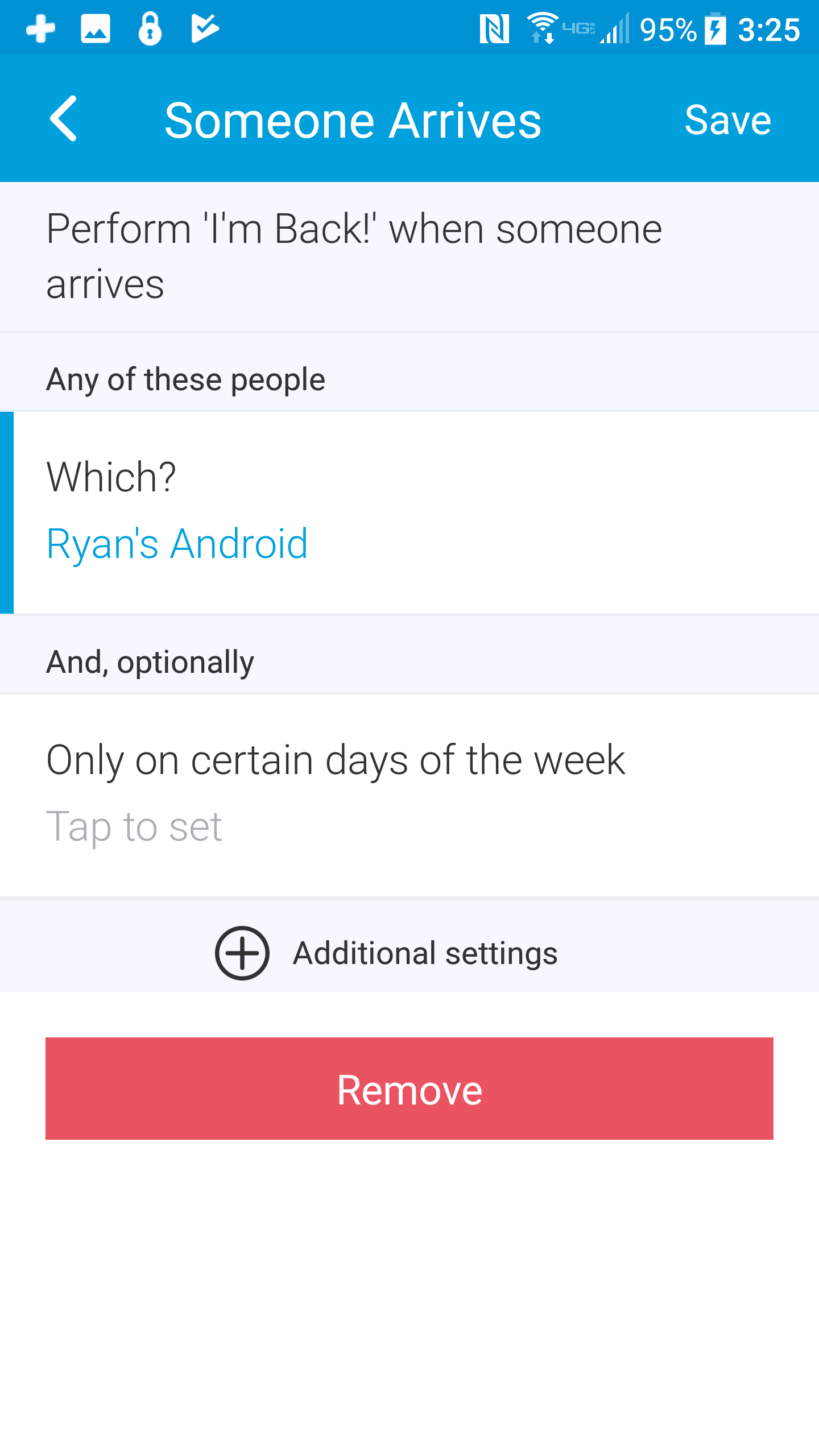

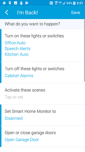

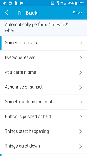

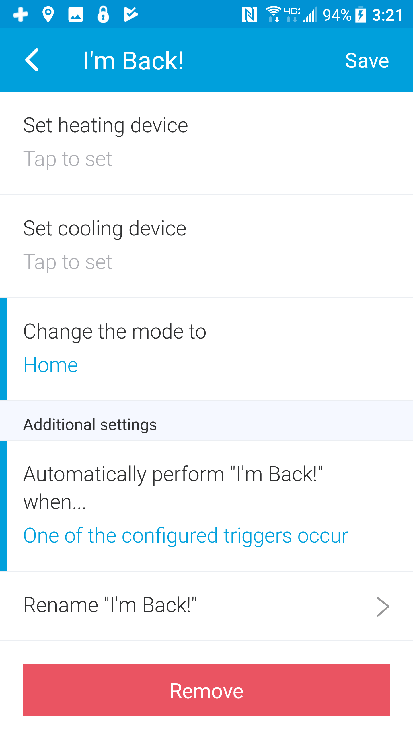

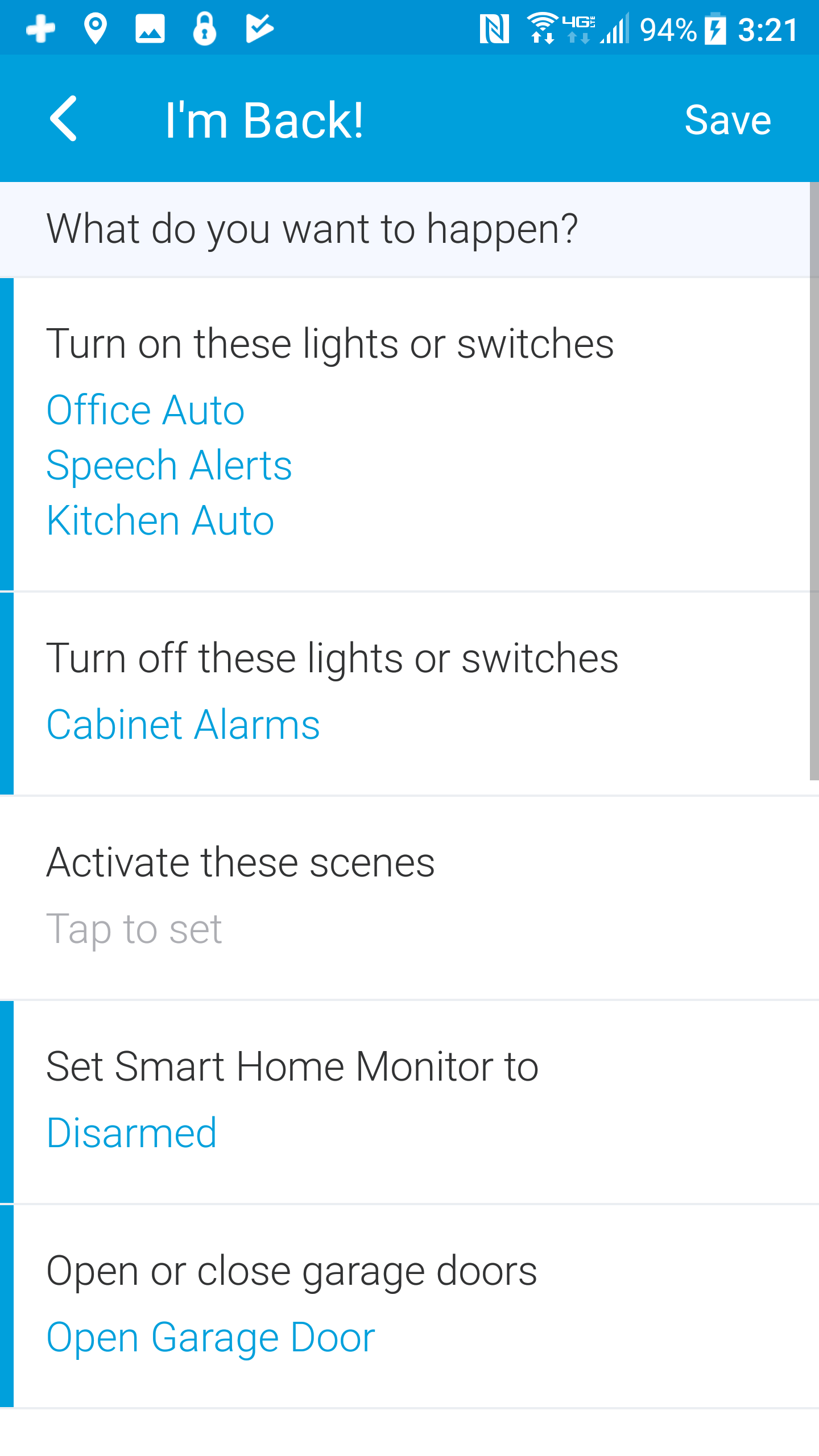

If you post a screenshot from your phone, that would be very helpful. For example, here’s the routine I run for “I’m Back”.
As you can see, I disarm my alarm, turn on some switches and open my garage door. Within the “Automatically perform I’m Back when…” is where I have my presence sensor (my phone) arriving home.

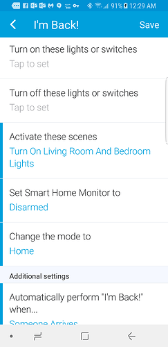

here is my screenshot. As far as I know!
back|243x500 everything looks proper.
how do you add “speech alerts”? That would be great to come home and have it say “welcome back so and so”!
