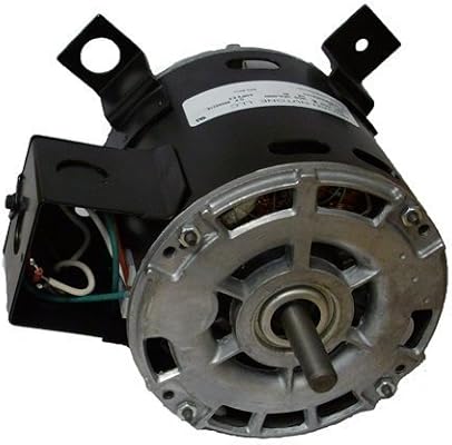

Is there no brand and model number anywhere on the fan?
This is what I could see from below. If I have to I could get to it from above but I’d like to avoid that if possible … it’s in a rather hard-to-get-to spot in the attic.

Amazon doesn’t even list it. Maybe try calling Nutone. They’re tech support might be able to help on a discontinued motor.

I was curious about this and happened to stop in a local electric motor supply and repair shop. I showed your motor to the shop attendant and he tried to look it up. He said Broan doesn’t list the HP since it’s an OEM part and Broan doesn’t like folks replacing OEM parts. They’d rather have you buy a whole new unit. The guy was very nice and spent about 10 minutes trying to find out. He wasn’t trying to get me to buy a new fan. They didn’t have any, I asked. Looks like you may just have to replace the whole thing with something quieter.
