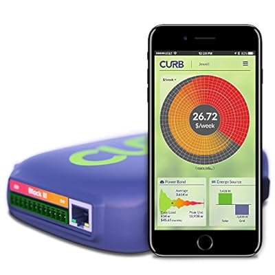

Look into energy curb. I have one and its pretty nifity.

Found CURB here, very pricy:
