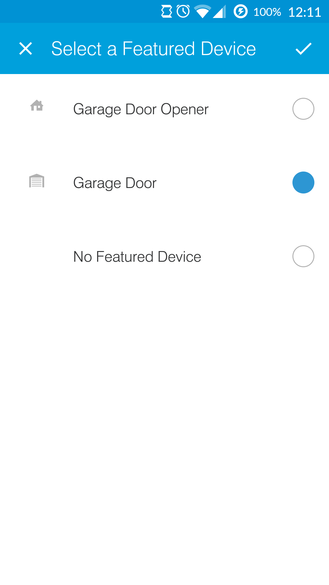

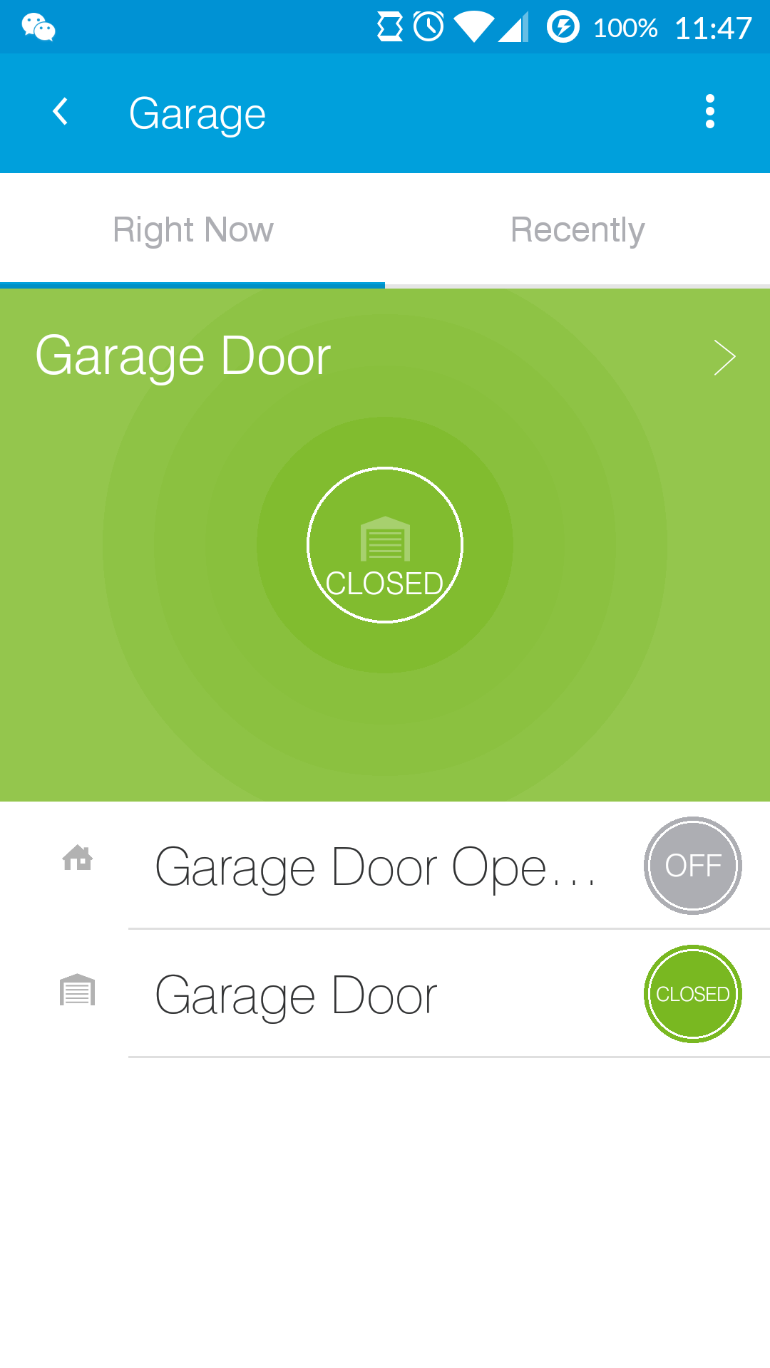

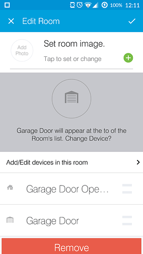

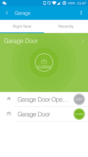

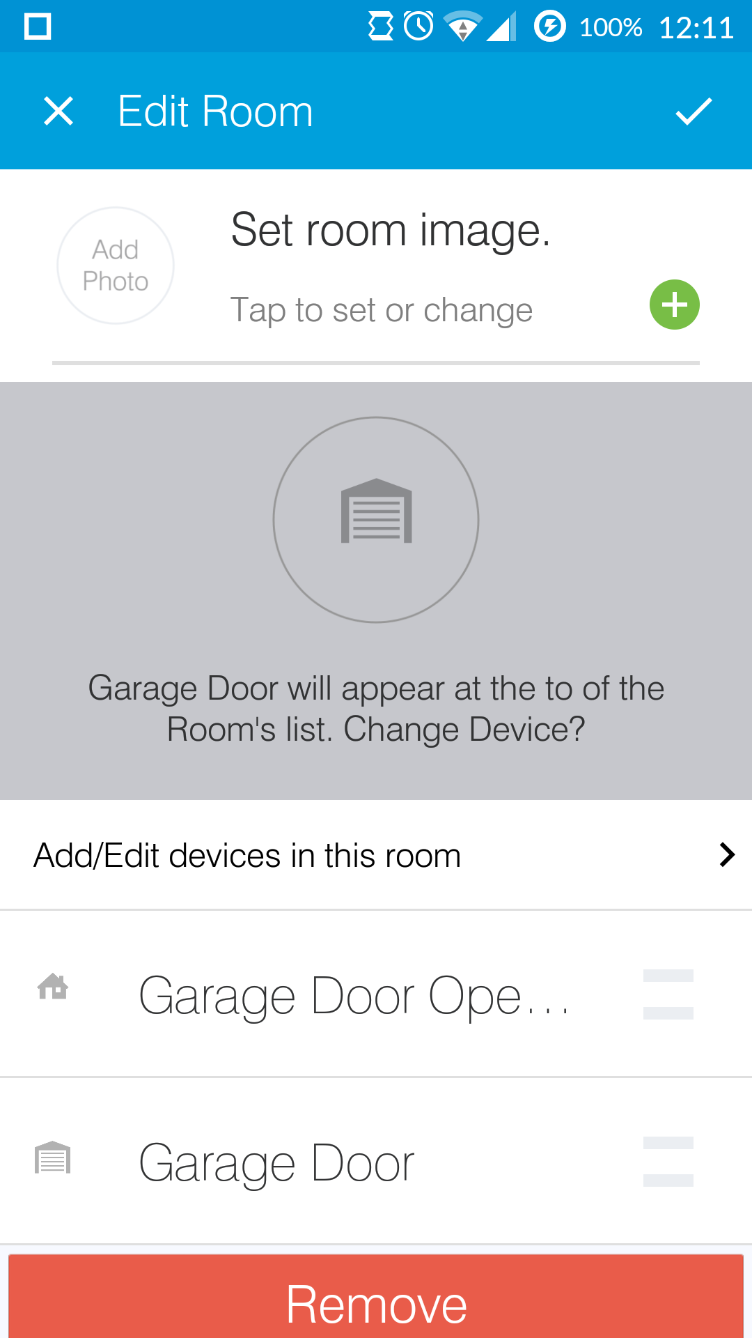

How about this?
Hint! You Press the BIG GREEN button at the top of the room!
Also, set the Primary device for the room to be the Tilt/ST Multi Sensor.

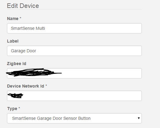

You can’t press the big green button if its just a multi and not a SmartSense Button. Its the button devicetype that gives you that functionality when using a multi-sensor/relay combo vs a myq device. Further if you put it in Doors and Locks you can save yourself a click or two getting there.
It work for me.
Agreed on this!

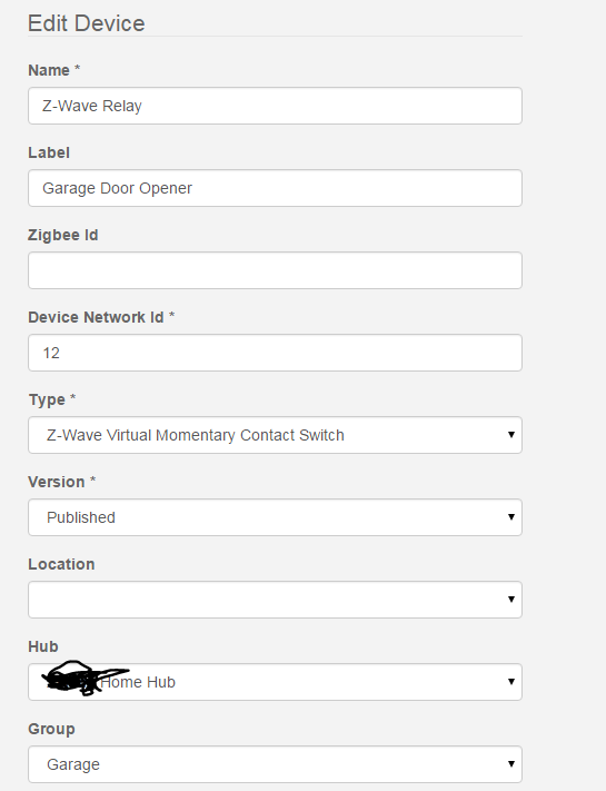

Make the following changes to your Z-Wave Relay and your ST Multi Sensor Device Types:
Doors and Locks, along with all other shortcut groups, is not supported in the V2 version of the official smartthings mobile app. If you have it, you only have it because you had it in the V one version and it transferred over with you. Once you remove the last device from that group, you cannot get it back again. And new people just starting with the V two app will never see it at all.
