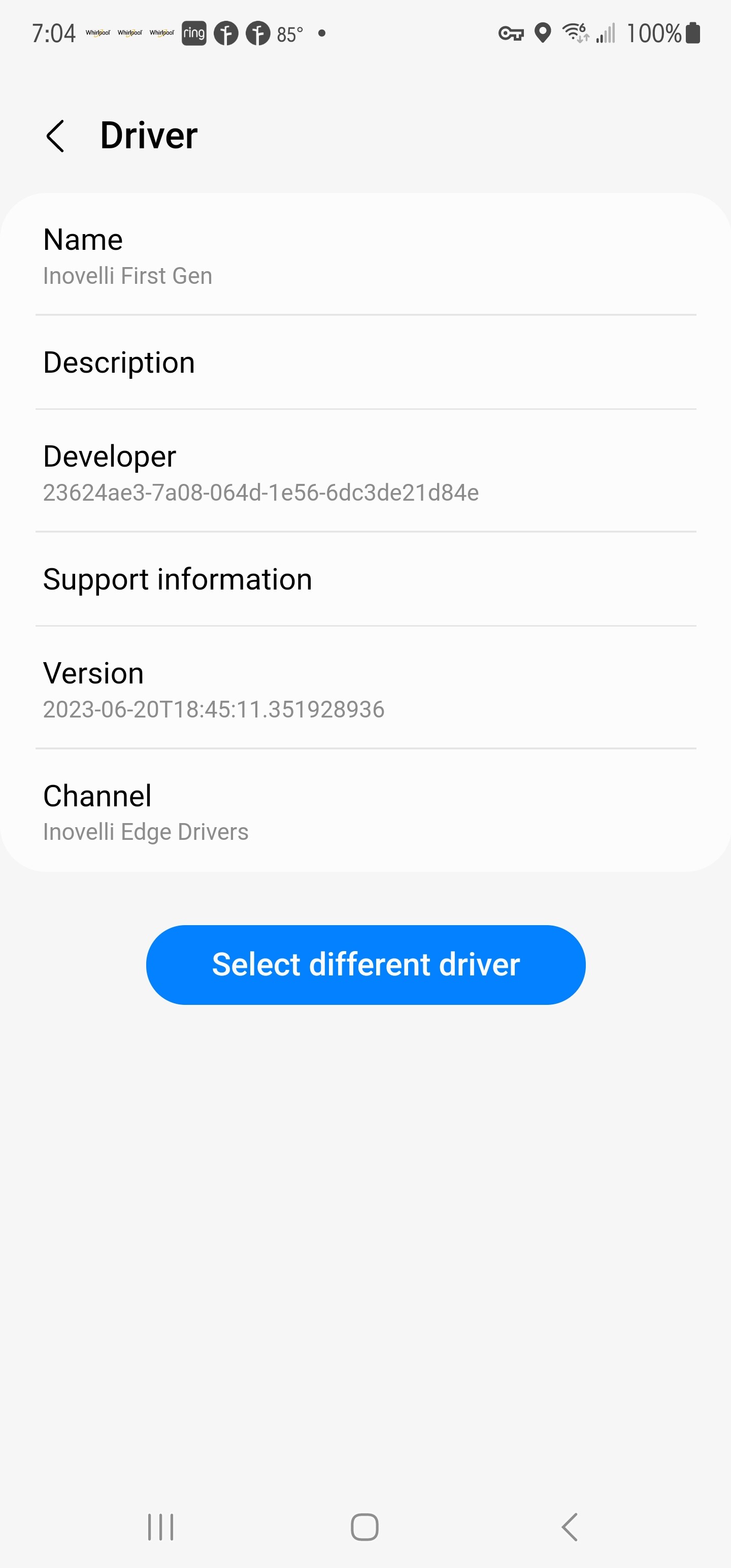

I am using the “Inovelli First Gen” driver. All of the drivers in the library refer to Red, Blue, or Black switches or dimmers, or 2-in-1, or 4-in-1, or a light.
After selecting the 1st gen, I tried toggling the switch 1 and switch 2 values between 0 and 1 to create a child device for each channel. No child devices is generated.

As a last resort, I deleted the plug from SmartThings and performed a factory reset on it. When I re-added the plug to SmartThings it immediately picked up the correct Inovelli Edge driver, and I was able to successfully add the Child devices. I appreciate your time and effort you spent trying to help me figure this out. I hope this thread helps anyone else who might be facing this issue.
