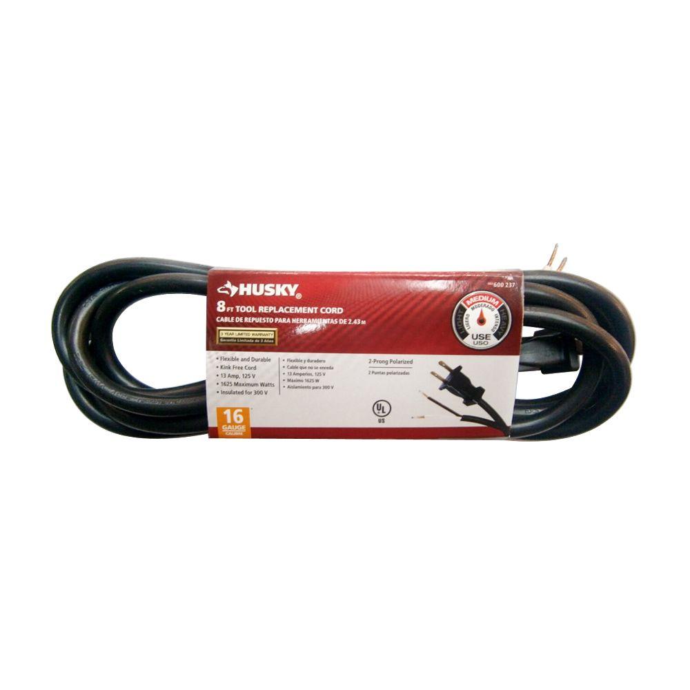

Setup is easy. Just follow instruction for the FS20Z-1 and connect it to power (you will probably need to buy a power cord and a electric surface mount box, total ~$10) and to the existing garage door opener (parallel to your remote/switch) and pair with SmartThings. Then change the device type to “Z-wave virtual momentary contact switch”… Done!

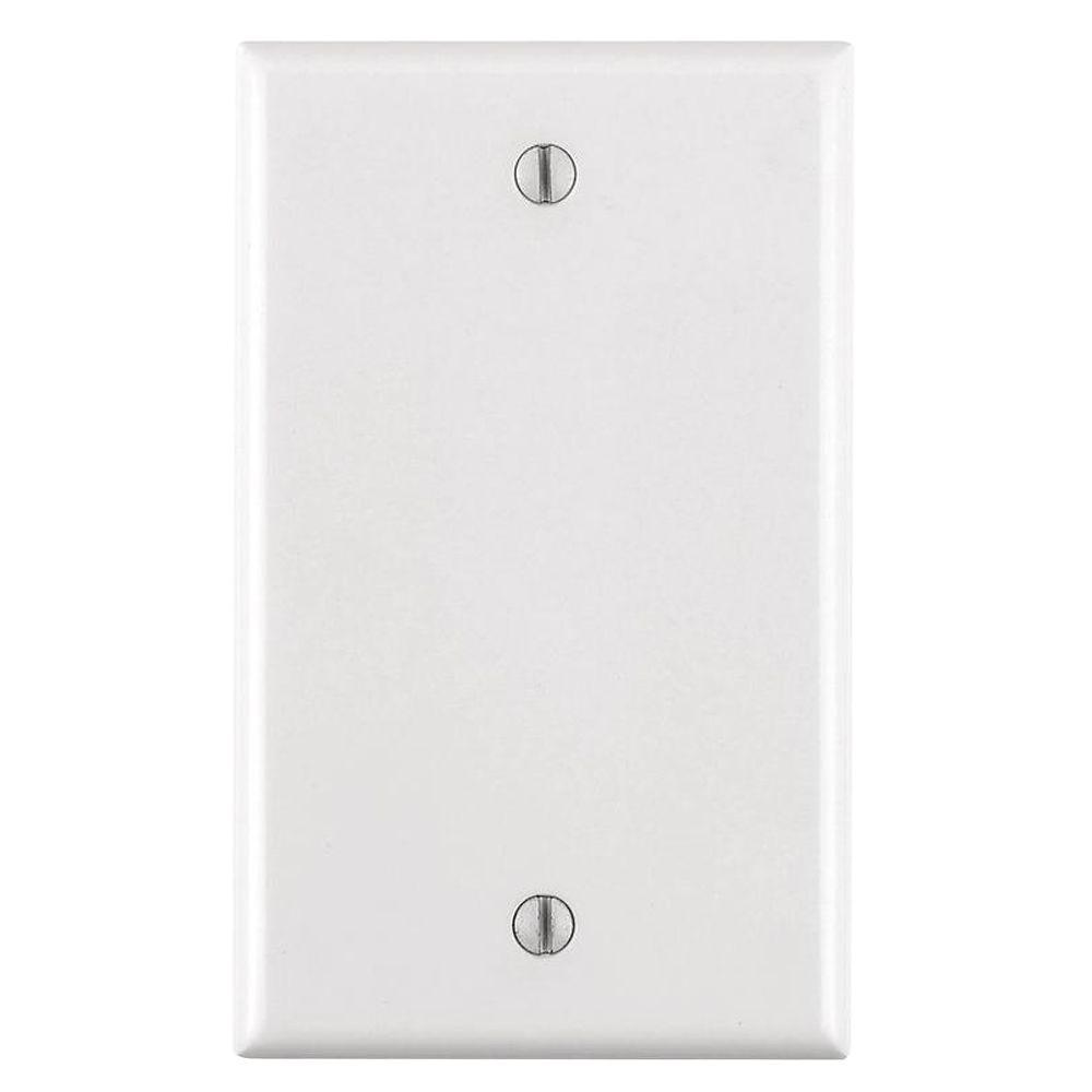

what am I looking for. I searched electric surface mount box at Home Depot and it brings a lot of stuff but not sure what I need. Also where my opener is mounted there are 2 plug points, one used the opener and I guess I can use the second one for the relay switch?

Unless you have an empty wall box with power for the relay, you probably need items like this for propper installation:
http://www.homedepot.com/p/CE-TECH-1-Gang-Surface-Mount-Box-5302/204265446
You will also need low voltage wires to connect the relay to the garage door opener.
