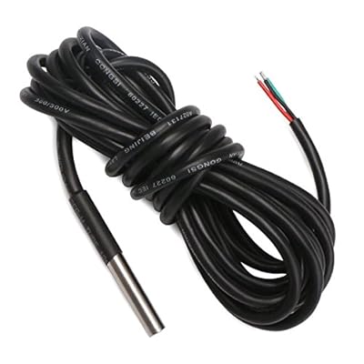

Next, the product descriptions on Alibaba are often incorrect, commonly because they copied the English from a different similar looking product without understanding all the differences. A lot of things are marked as “Wi-Fi” which are actually zigbee or Z wave, some things are marked “US Z wave” when in fact they are on the Asian frequency and would not work with the SmartThings hub. And some are marked “zigbee” when they’re actually accessories without any radio at all. I can’t be sure on this one, but that’s what it looks like – – that this is just the probe sensor, not the networked piece.

The DS18B20
In this particular case, you can find the same probe from very reliable sources, including Amazon, so you might want to just consider sourcing there.
Again, this particular piece doesn’t have a radio – – that’s what you’re going to use the Fibaro sensor for.
