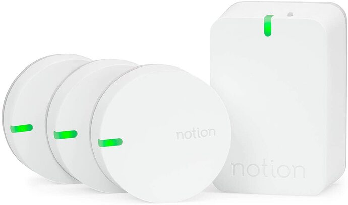

If you want something fancier (and more expensive) the “notion“ system seems to be well engineered and has a good IFTTT channel. You have to use them with their own bridge, but you don’t need a smartthings hub. Integration is through IFTTT. Their sensors are multi function, and can be used for leak detection, motion detection, a couple of other things. The cost is high, $149 for the bridge and three sensors, but they get good ratings and they do a lot.
My biggest concern with a company like notion is they are essentially in start up mode. Good engineering, lots of cool features, Nice aesthetics. But I don’t know if the company as a whole is financially viable or if they are just hoping to be bought by someone else. So I think there is a little more of a risk that their system might shut down in the future. of course there’s always a risk with any individual model that a company might discontinue it, but with something like this one, if the company goes out of business the devices will just stop working altogether. So just another factor to take into account. :thinking:
