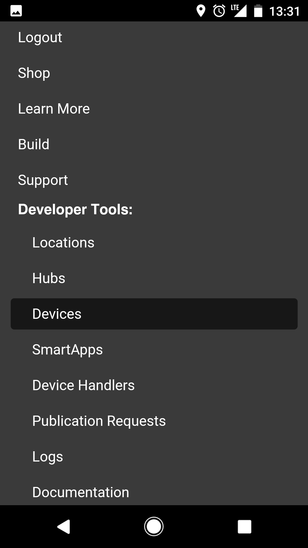

  1. Go to the ST IDE from here https://graph.api.smartthings.com depending on what shard your location is at. You created a custom DTH previously for the sensor so obviously you do know your shard. If not then go here Different Shards Confusing Need Help
  2. Once you are in IDE. Click on devices.

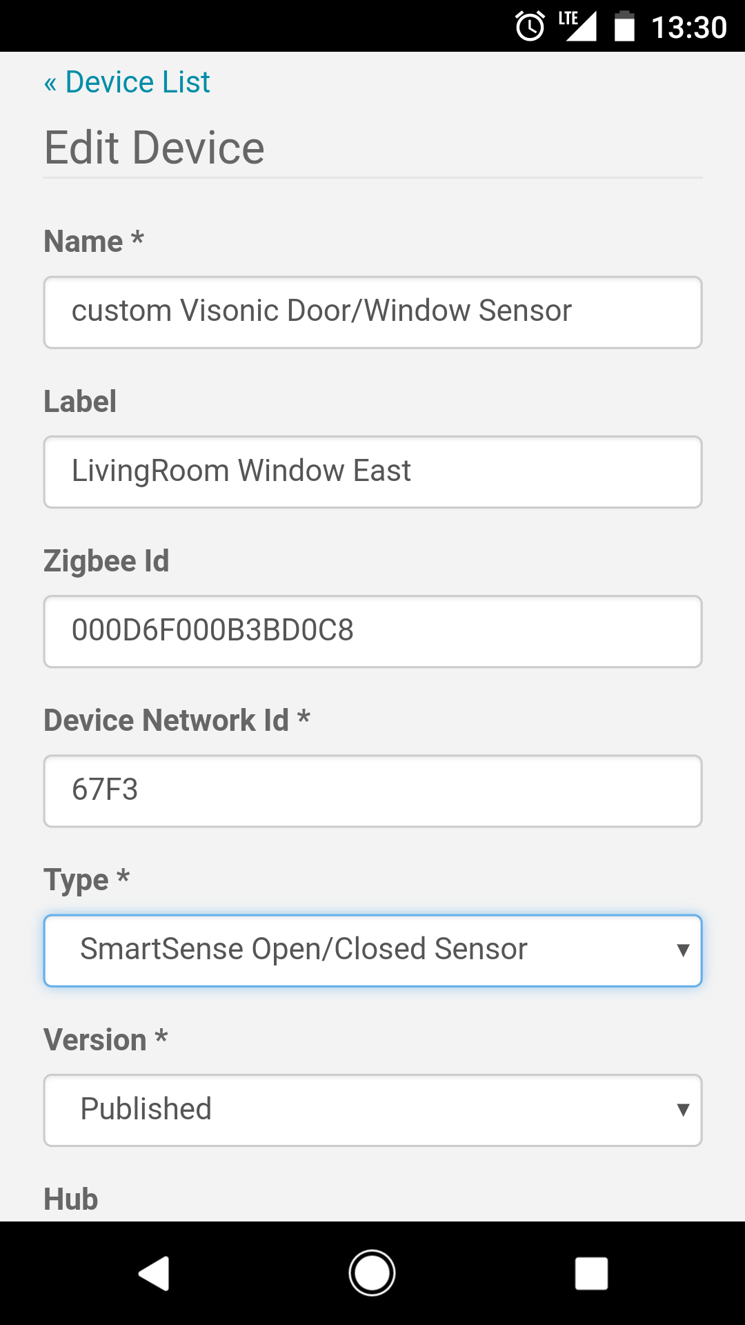

  3. Click on the Visonic device you want to change the DTH then click edit at the bottom of the page.
  4. Click on type and you will see a drop down selection of all the DTHs. Select smartsense open/closed sensor then click update at the bottom.
  5. Go to this site to confirm the device you just added is now qualified for local processing
