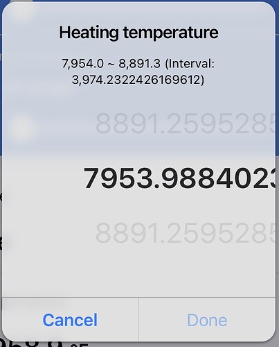

Virtual Thermostat - temp range broken?
What’s happening with the virtual thermostat device?
Something is clearly wrong here …
The native virtual thermostat device? Try to set the values through a routine.
Is this one of the native ones and is it freshly setup? If that’s a yes and yes then I suspect that it remains the case that as part of their creation process they get initialised with synthetic events which seem to be random and often improbable in the real world. This was something that started a while back. I found it particularly annoying that they did it with custom virtual devices as well as the standard ones as I was already handling that.
The bottom line is that you may need to initialise the attributes to sensible values yourself. That includes the valid values.
If it is a previously working device then that’s another matter.
Yes, the native virtual thermostat. And no, I can’t just set the values using a routine because the range of accepted “valid” values appears to be completely out of whack…
You need to use the CLI (or the API in some other way) to set the values.
Nope, doesn’t work. Get “unprocessable entity” error when trying a POST command.
Again, this would clearly seem to be because the accepted range is broken - and indeed, appears to return as “[object Object],” which can’t be a good sign!
*Update: so I can manually set a set point through the CLI, but it still shows as “out of range” & can’t be adjusted in the app.

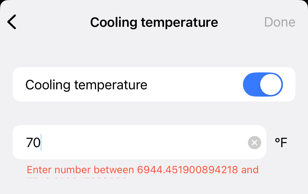

Thanks, I really appreciate your comprehensive assistance! So following your guidance I was able to adjust the range and I’m no longer seeing the out of range error …BUT I’m still not able to adjust the set points through the app (routines also still dont work).
The new error is a generic “network or server error” box:
Is there something else I need to initialize / tweak?
