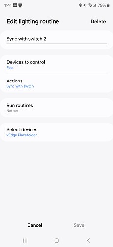

And yet another option could be to use Smartlighting in ST to sync the state of the Lighting Group to the virtual switch.

Thanks, that was a good and easy suggestions. Never used the Smart Lighting option before. Going to give it another look what else can be done with it.
My Lighting Group is Foo. My virtual device is vEdge Placeholder which you can also see in the Alexa app.
