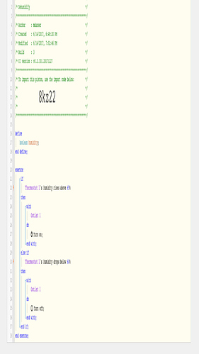

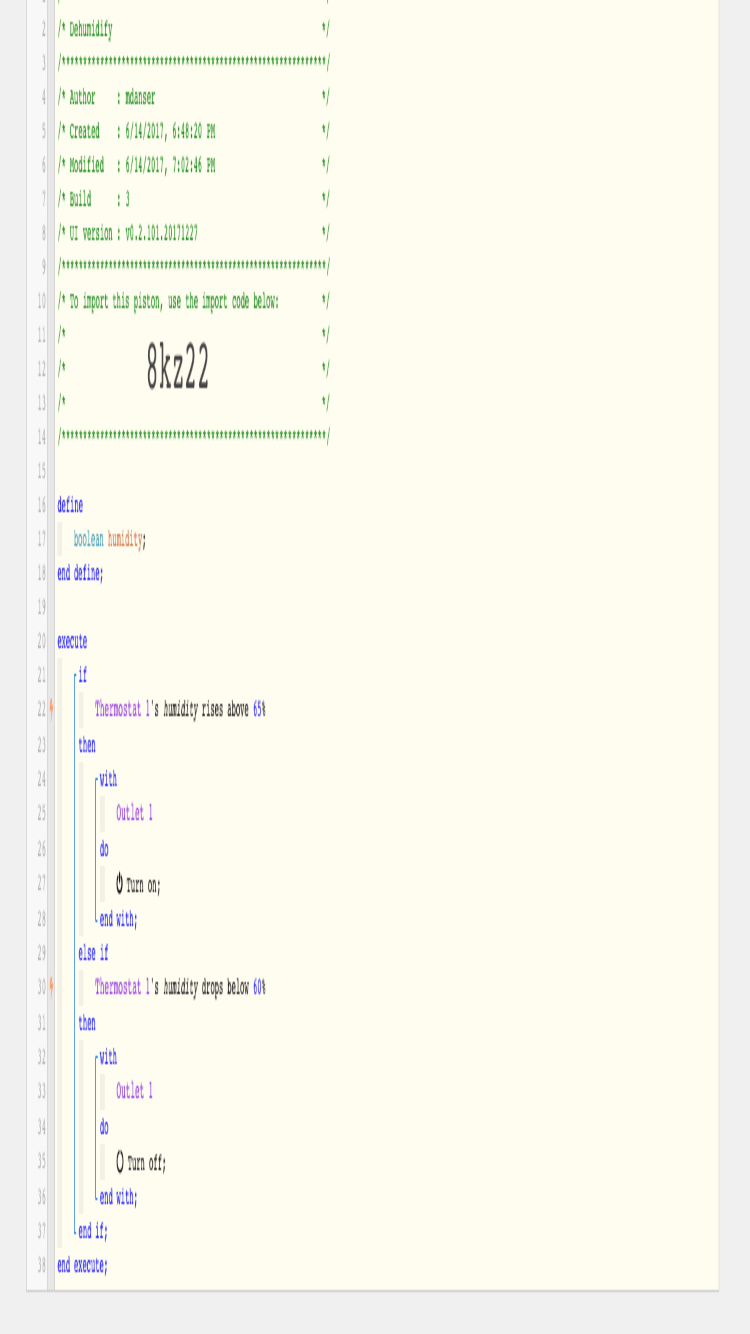

I do this in webCoRE using a plug in 120V dehumidifier.
Yup - just monitor equipmentStatus and when that string contains the string ‘,humidifier’ then turn on the humidifier (or when equipmentOperatinState contains ’ hum’). Note, however, that the Ecobee 3 & 4 will only humidify when the heat is on, and the heat will turn off when the temp is reached (which is likely to be before the humidity is reached).
Better approach is that shown by @Michael_D - just use the humidity sensor in the thermostat. If you want to take advantage of the humidity setpoint that the Ecobee calculates (based on you window efficiency and the outside temperature), you can used the current value of thermostat.humiditySetpoint as the target instead of hard-coding it.
You can select the humidity sensor in the Ecobee thermostat as you can for any other device, so you won’t need a separate device.
