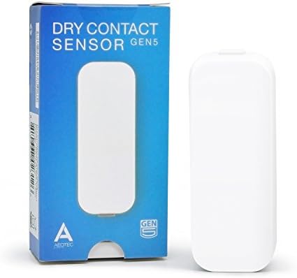

  1. glassbreak model#? If it’s a “GBD plus” you’ll need to maintain 9-16vdc to the glassbreak. You can leave your old alarm panel hooked up, maybe an eyesore, or provide a dedicated 12vdc supply to replace the power that was coming from the panel. So you’ve still got that thing on the wall or somewhere.
  2. you would add “dry contact sensor Zwave module” for your normally-closed (NC) glassbreak contacts which has 27ohm inline. That end-of-line resistance might be a problem for the Zwave module so don’t buy a dozen sensors without testing one first - it might just work.
such as Mimolite or
If the inline resistance is a problem then I would try to eliminate the 27ohm which may be a jumper or DIP setting, or a solder hack.
