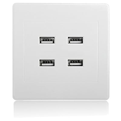

Try amazon…
Or…

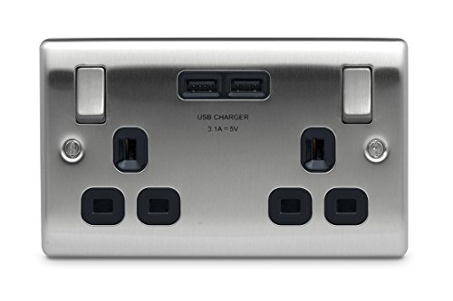

the 3 pins are annoying as it will be likely installed near the ground. and running a cable up is not clean. the second is more like it. I have 2 single ones like this and I run them in my light switch but its not recessed so the cable sticks out so the tablet cant go there. I want invisible.
Thanks though. might help someone.

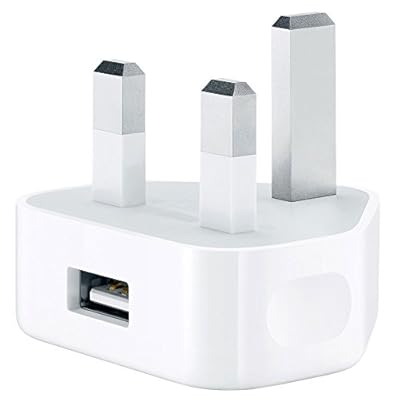

If I was mounting a tablet on a wall… I would
  1. Sink a single patress into the wall
  2. Run power to it via a fused spur
  3. Crack open something like this
  1. Solder power cables to it after removing the case, pins etc.
  2. Encase it in heat shrink - leaving just the usb socket free
  3. Cover it with a flush fitting blanking plate with a hole for the usb cable to come out
Now that is a great idea! Slim line enough too. I wonder how easily they come apart. I have a good few of these laying around.
Done right the wires can be consealed making it safe to touch too.
You can buy different sizes of heat shrink
I’m sure you could find one big enough to cover the circuit as well as the connections
Yeah I have a big Range. I’ll have a play and let you know.

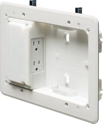

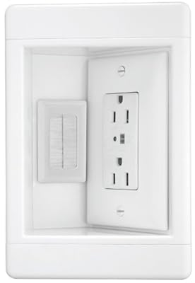

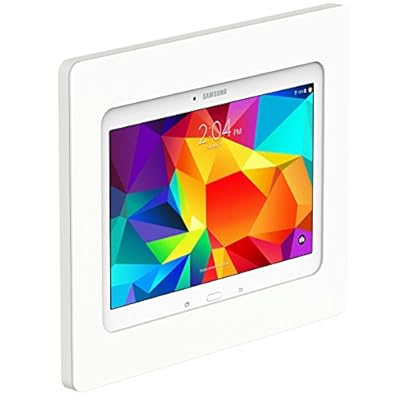

they sell wall frames on amazon with the power connetion behind the tablet in a recessed box, like a tv on the wall
The issue in the UK matt is whilst you can get mounts the recessed USB port does not exist. we have a couple of options for face plates with USB but recessed are USB ports that need to be powered from elsewhere.
Also recessed 3 pin sockets are quite chunky and I don’t have the wall depth.
The Apple charger strip down looks promising. I found an article online on a teardown and I think it should be possible to make it work. if lucky I might even be able to completely enclose it in its own case so no wires are around.
typically these are placed in the same stud cavity above a power outlet. Then run the power from that outlet up inside the wall to a new outlet. The recessed boxes have angled slots for electrical boxes to sit a bit sideways.
I’ve also seen super shallow boxes and outlets.

Using an apple charger with the 3 pins removed and hard wired to the lighting circuit made safe if accessed to change a usb cable should work. and will be a cheap and clean function.
