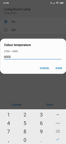

I recently purchased a Innr Smart Bulb Colour E27 and connected it to my SmartThings hub, everything works fine except that I cannot lower the temperature lower than 2700k. The product description states that it supports between 1800k and 6500k.
I’ve checked the device via “My Devices” and it is using the ZigBee RGBW Bulb device handler.

Same issue, when I open the Android app the slider is maximum cool white but says 4000k, I cannot slide it but only move it to it’s minimum, that tried to set it to 0k, then the slider moves back to maximum cool white but now says 1802k

@vassie, I see the issue with the fingerprint for the “RB 285 C” not specifying the UI Metadata for 1800-6500 and I can get that fixed. However I’m not seeing the issue with the color temperature control that you’re experiencing. For me the range shows 1800 at the minimum and 6500 at the maximum like I’d expect. If removing/rejoining the device doesn’t fix it I suggest you contact support to report the issue if you haven’t already done so.
Hey @tpmanley thanks for the reply, I’ve removed and readded the device but using the Android app I can only adjust the temperature from 2700k to 6500k.
