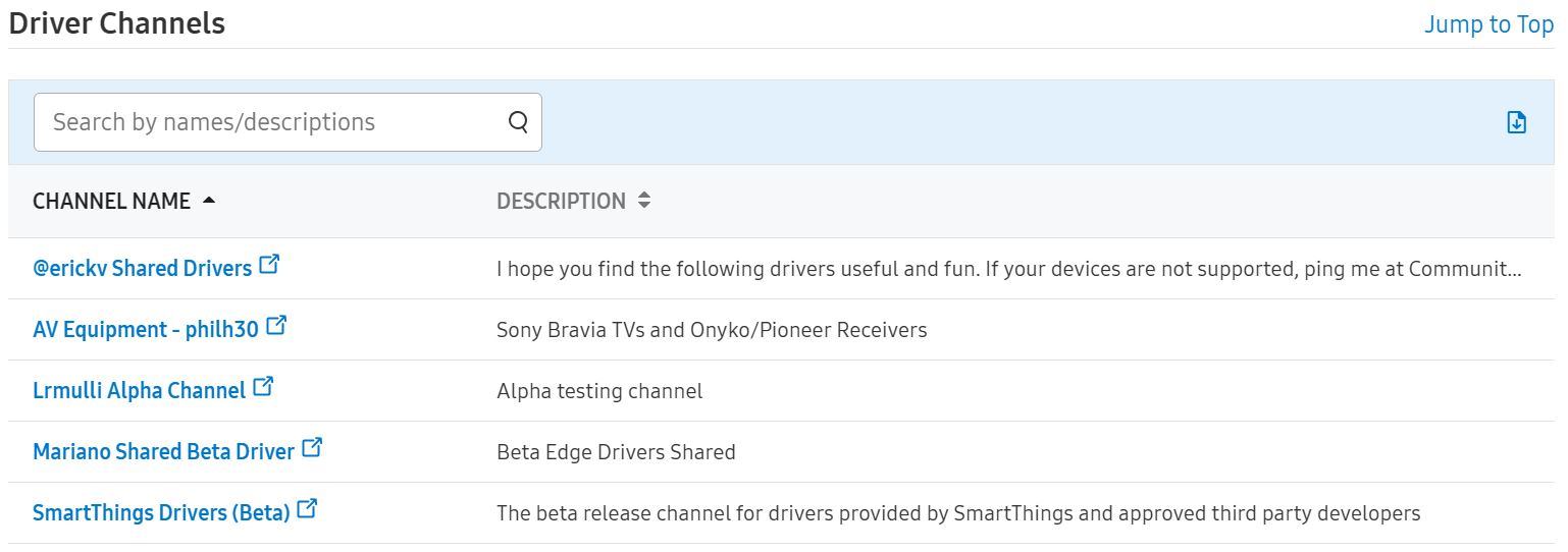

my.smartthings_com/advanced/hubs channel links work for me.
