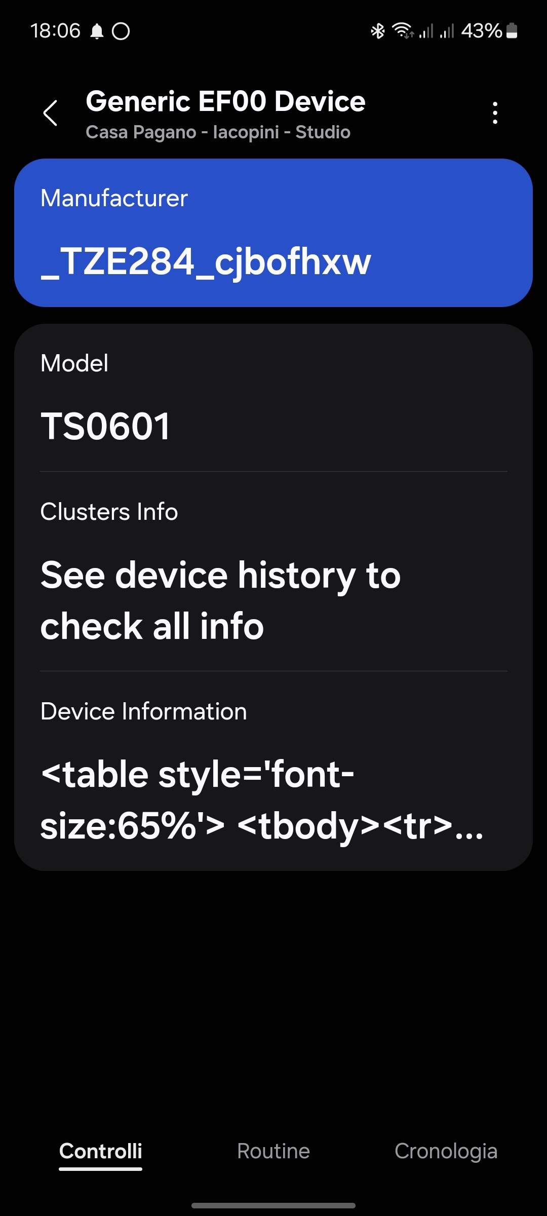

here I am the model is TZE284 cjbofhxw I attach the screen

Hi @Mario_Pagano , I’m away from my computer at the moment, but I’ll get back to you as soon as I can.
Hi @Mario_Pagano, im still away from my computer but i have another question? Are you using one or two clamps?
one clamp…tanks
Hi @Mario_Pagano , sent you a PM a minute ago.
