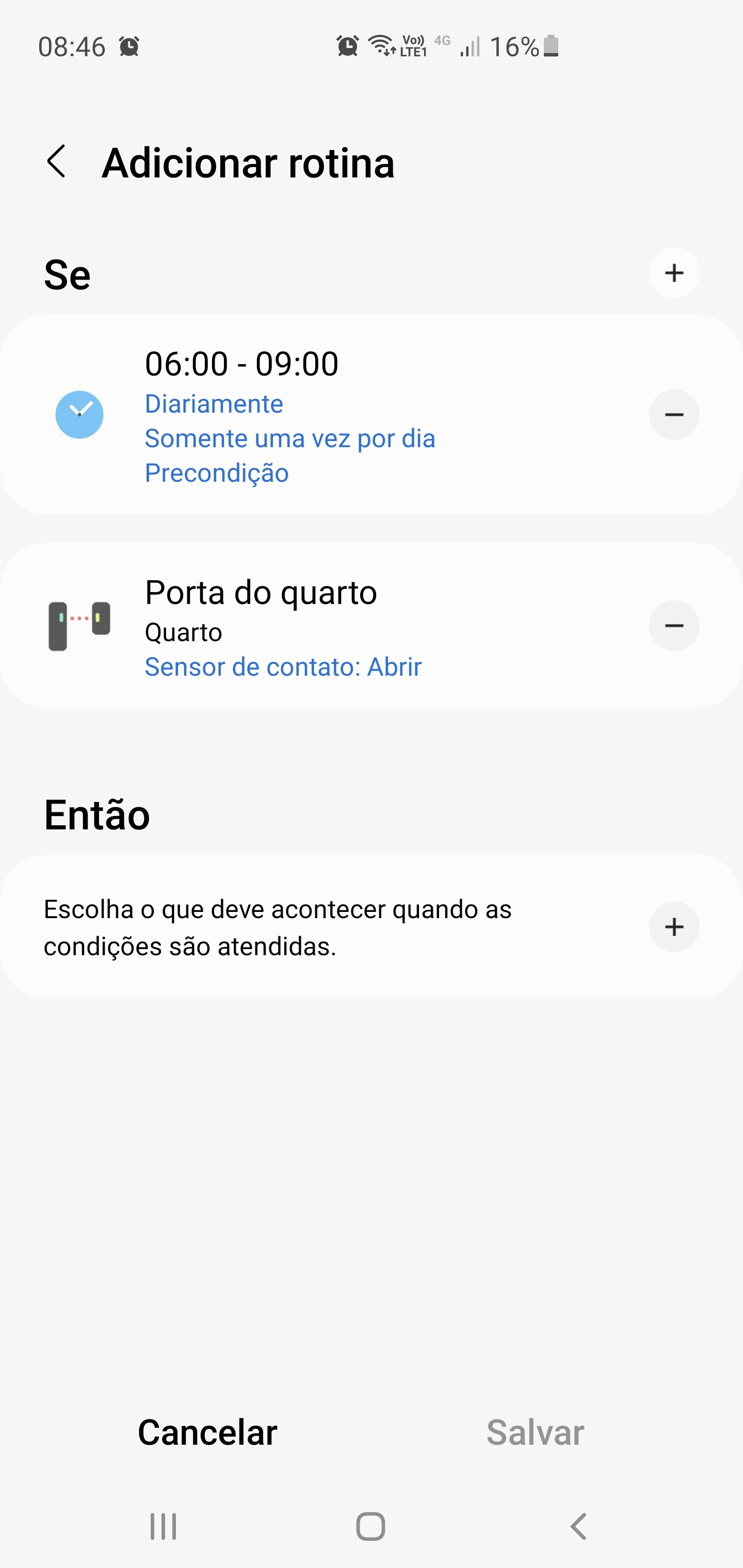

I tried to create a routine, but it won’t let me do what I want. For instance, for the routine IF clause, I select IF door-switch is OPEN and that part is ok so far. But then I need to say “AND door has been closed for x+ hours” THEN, and its this second part I don’t know how to do.
I can see how that would work, thanks. Although I think that is a pretty cludgy way to have to do it. Imagine more complex rules, and several dozen automations. There could be possibly hundreds of switches needed for everything. Is there another way? This is where webCore shined. Is there some sort of programming language alternative coming to replace the functionality what webCore provided?
Routines are just very simple guided automations built into the app. They are what they are.
The underlying engine is the Rules API and that is the place to go for more complex automations. It has a way to go to match webCoRE capabilities, if that remains an objective, but it is a lot more powerful than Routines.
