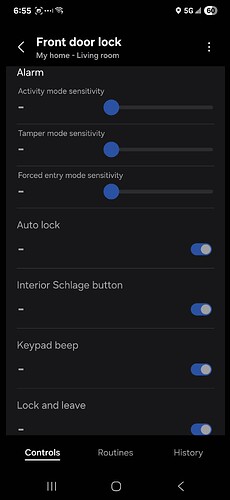

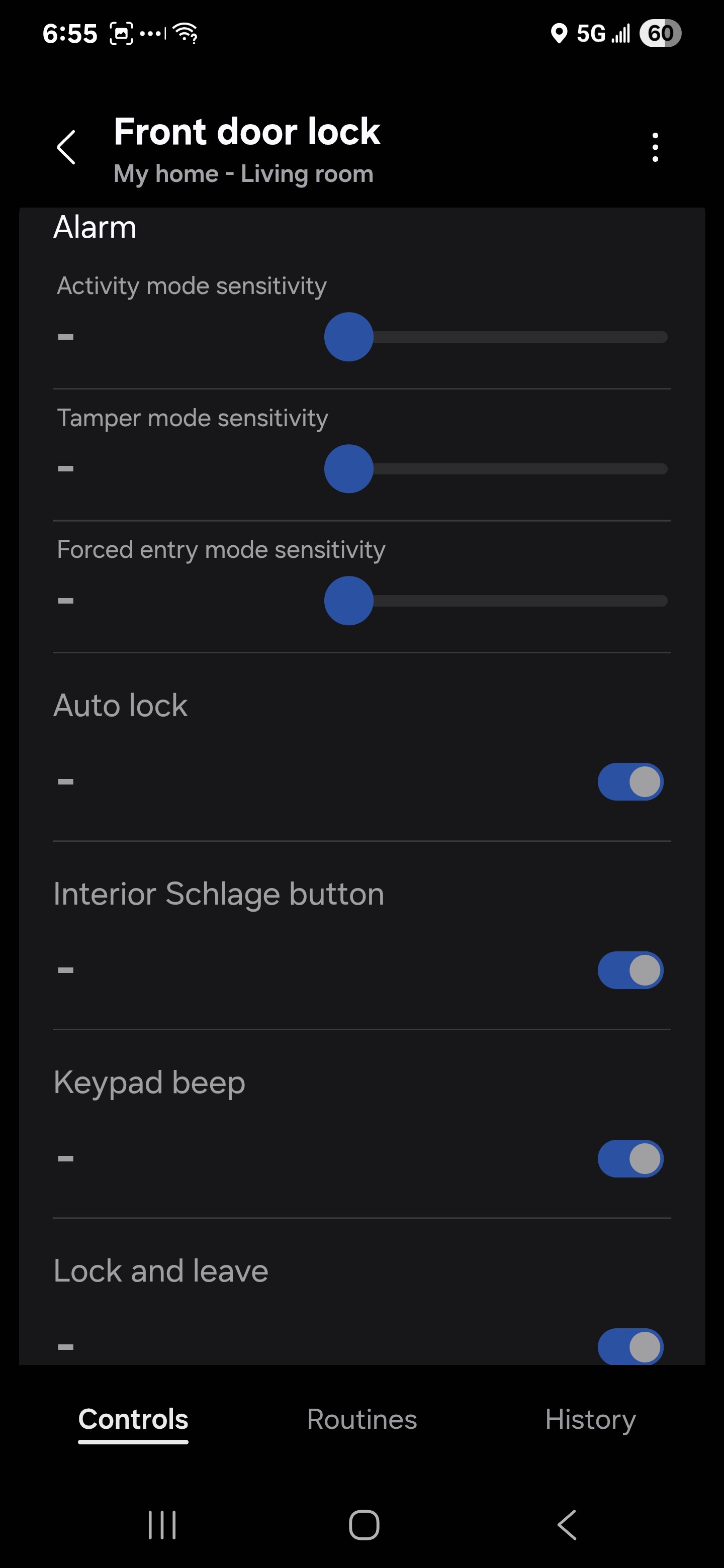

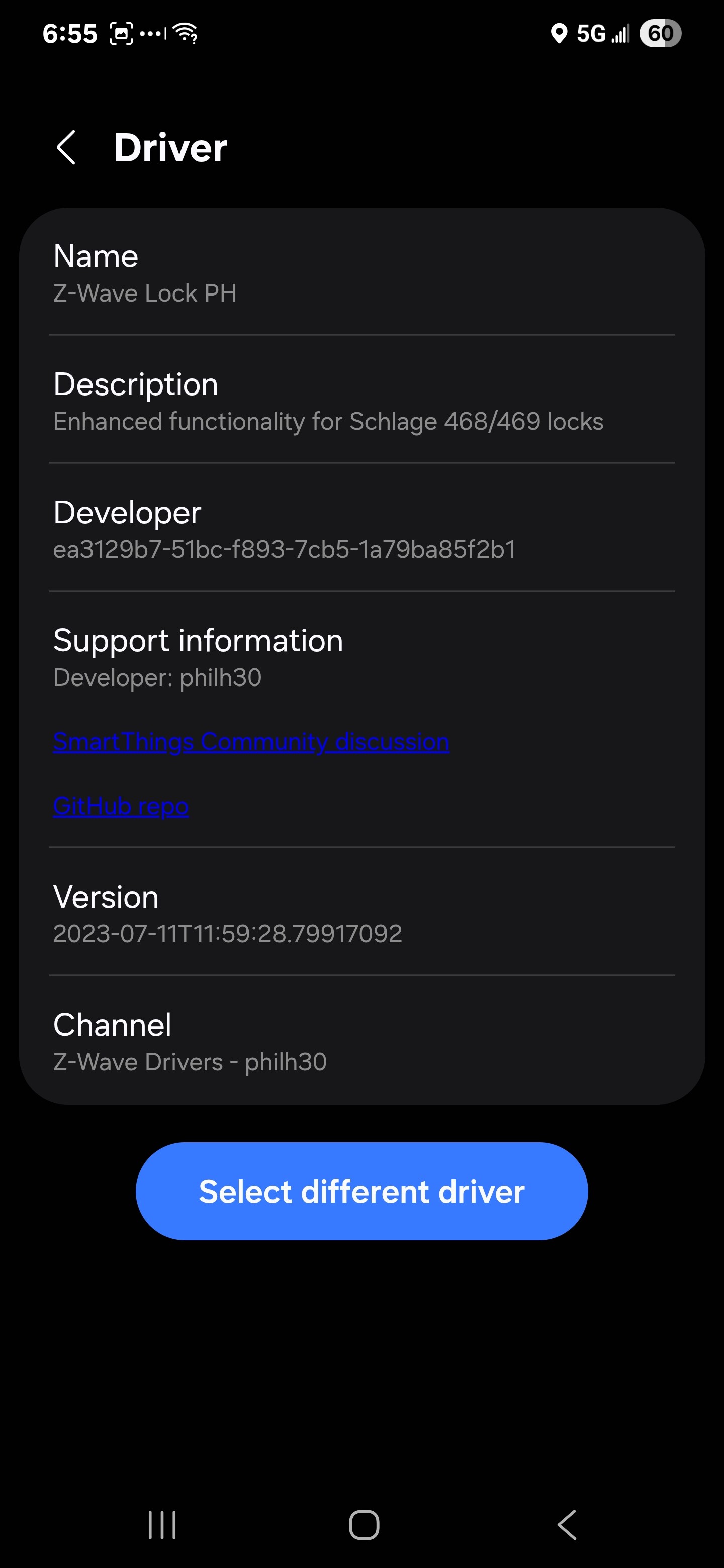

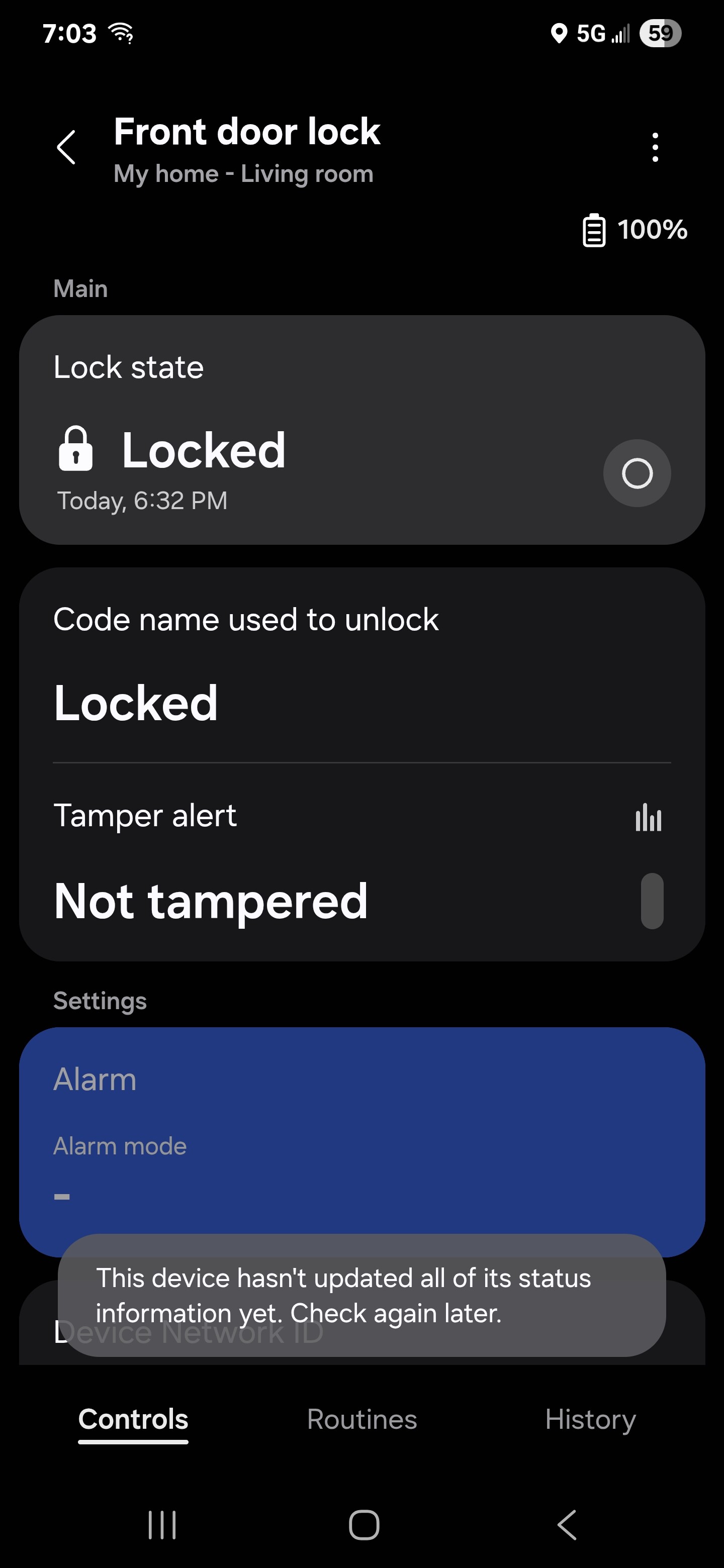

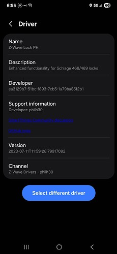

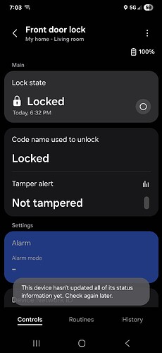

I performed the exclusion and after several attempts was able to include the lock. After adding the lock to SmartThings I see this:
When I open the tile there is a message that pops up on the bottom of the screen for a few seconds. I cannot access any of the radio buttons or options presented.
Does anyone have a solution for helping me get access to the features in the driver?
