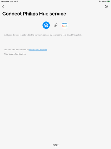

Are you able to see the screenshots I posted? The “linking your accounts” option is in tiny print and fairly hard to find.

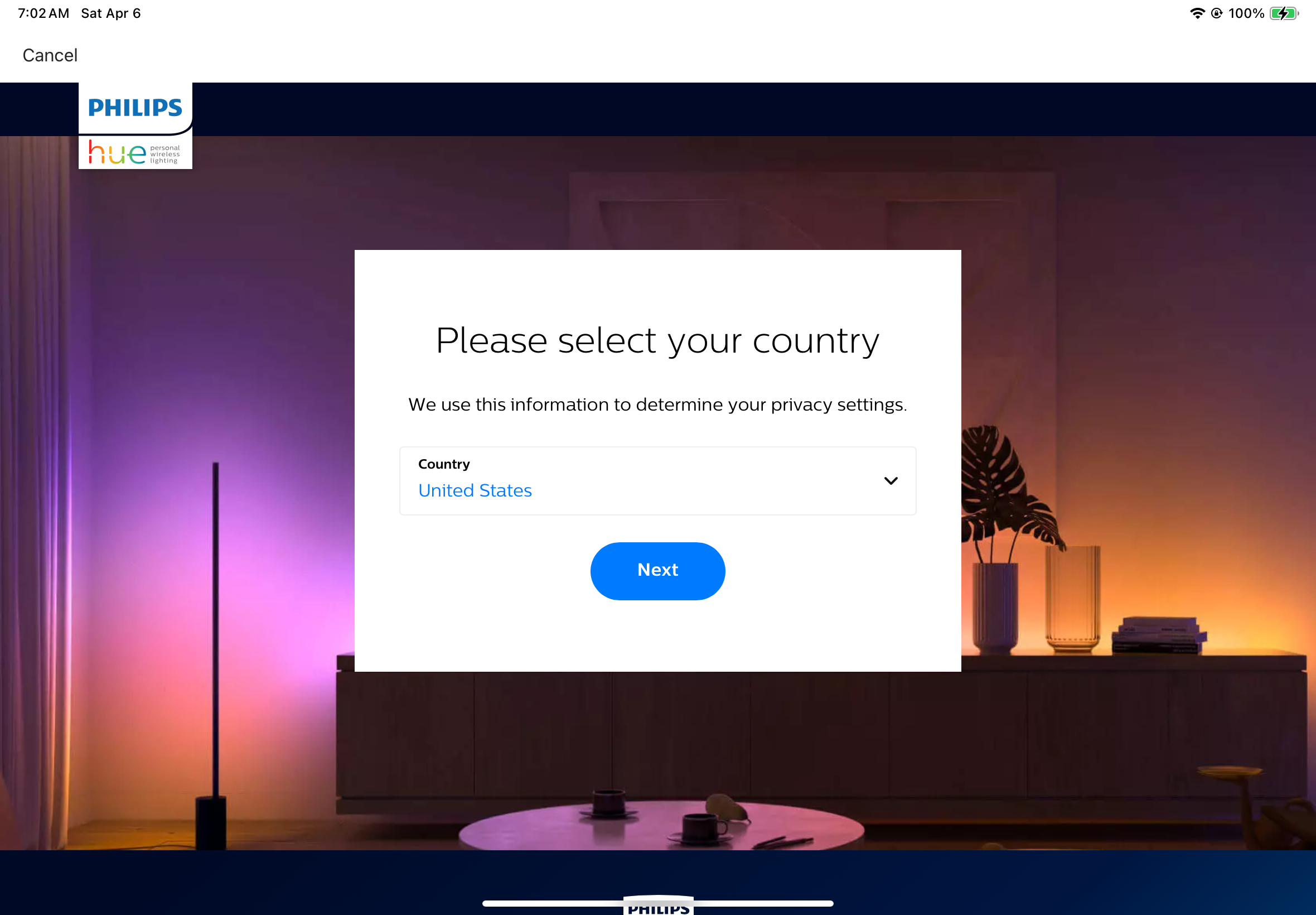

They’ve changed things. Now, if you don’t have a hub on the account at all, you do have to click “next” at the bottom.
the screens look like this.
I was not able to get to the same screen that the OP has, so that’s why I asked what exact path was used. :thinking:
this is what I see:
which matches your first post.
That’s because you have a hub on that location.
We have two locations. The first has a hub, the second does not.
The first set of screenshots I posted were from the first location. On the screen for that location, clicking next will start the processes that require a hub.
The second set of screenshots I posted were from the second location. You can see that there are fewer options and the wording is just a little different: there’s no “also “. Clicking next on that screen will start the process that does not require a hub.
