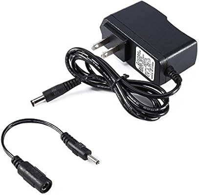

You can use “any” decent 6v AC-DC power adaptor, but have to cut the output wires to attach the snap-on style 9-volt battery style connectors. Total cost under $20.

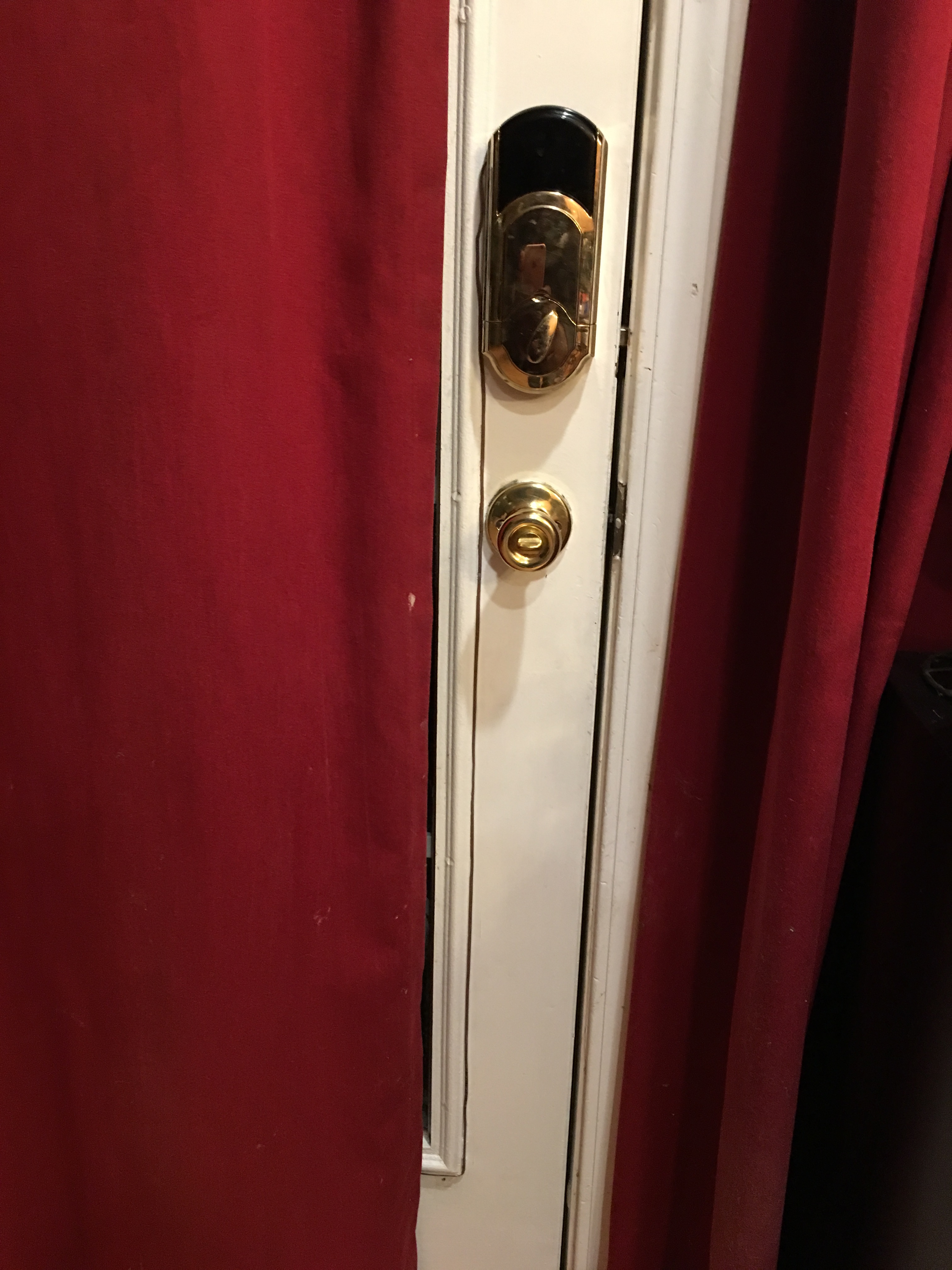

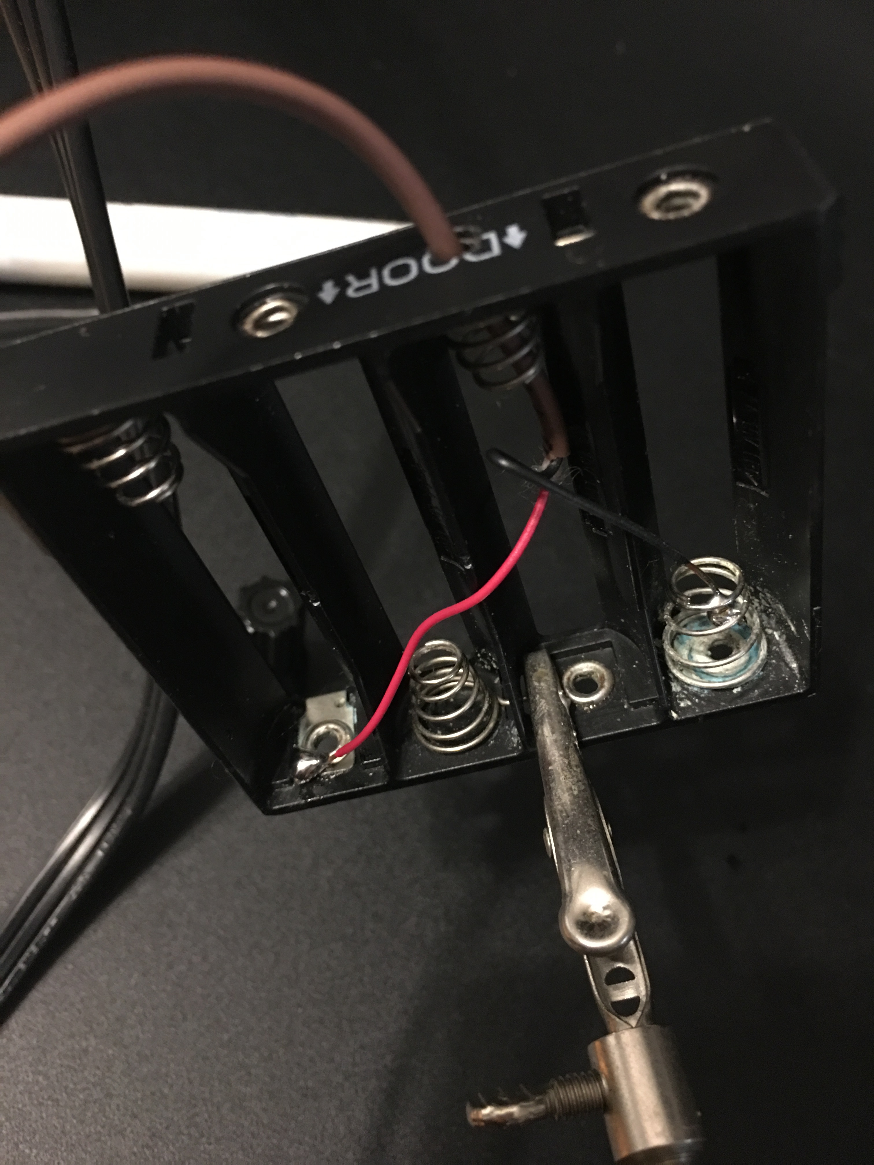

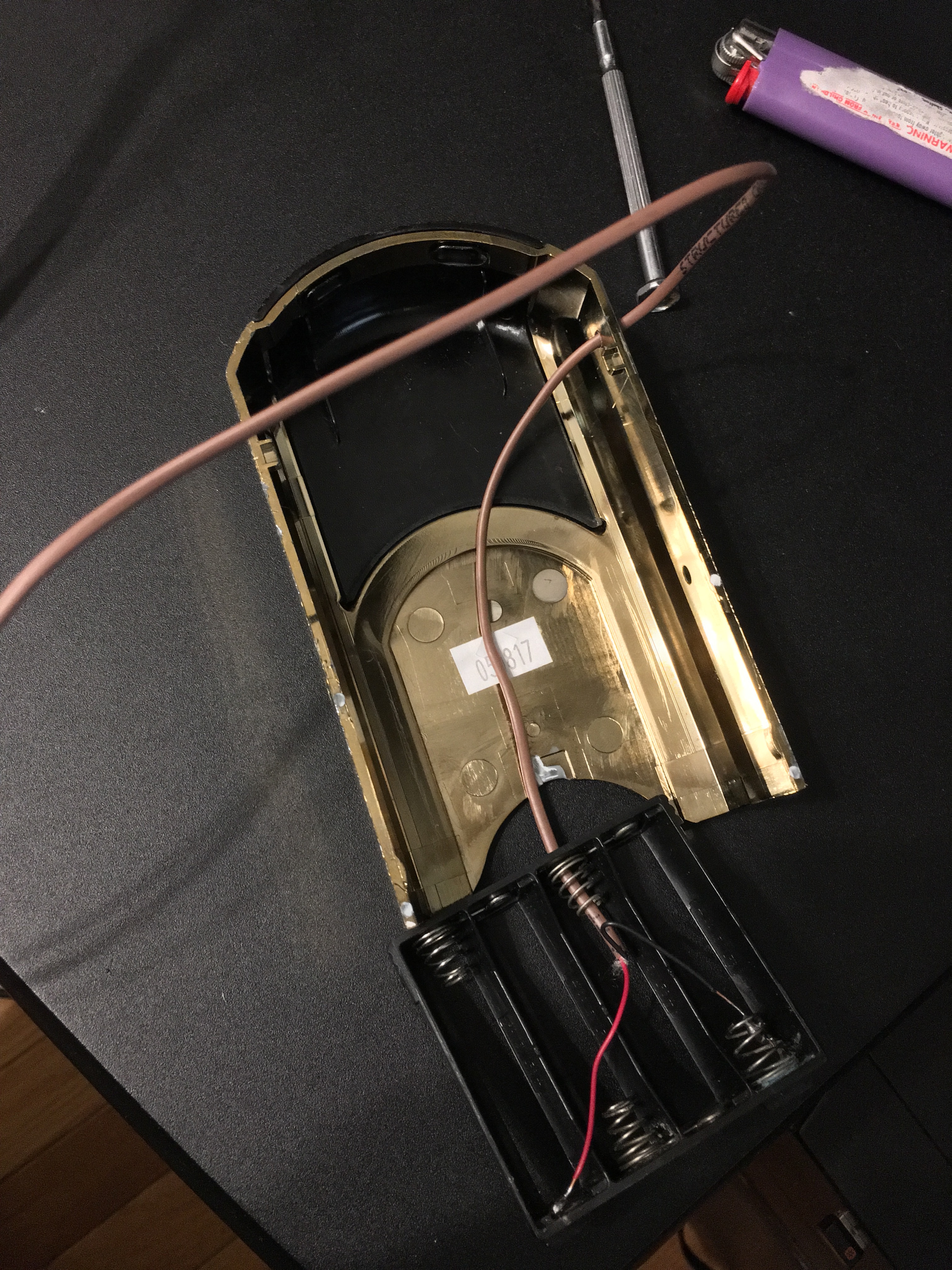

I purchased a 6V1A plug in converter and used 22 Guage wire for the run and connected positive to positive and negative to negative on the battery case and wire ends. Pretty easy project and no more changing batteries! Even took it a step further and put it on a Smart Switch so I could easily reset the lock if/when it looses connection. As you can see by the screenshot below, it uses hardly any energy!
