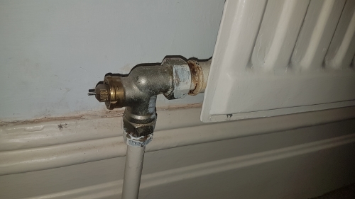

I bought these smart TRVs to try them out and see which one worked better:
- Popp POPE010101 Z-Wave Radiator Thermostat
- Devolo Home Control Radiator Thermostat
…Only to find out they’re exactly the same hardware!
I have a problem though, in that they don’t fit on my radiators. Has anyone had experience of getting adapters so they fit? And can make recommendations? I’ve attached pictures of the valves.
sorry im new i have managed to connect a lot already but i want trv i saw Lightwave RF will these work or would i need to do something to make them work
It looks like a RAV 34mm diameter valve.
Try look at the pictogram on this page:
https://www.bygxtra.dk/produkt/danfoss-fast-foelerelement-2960/
I don’t know which valve type your thermostats are, but if they are M30 x 1.5 you can try with one of these:
