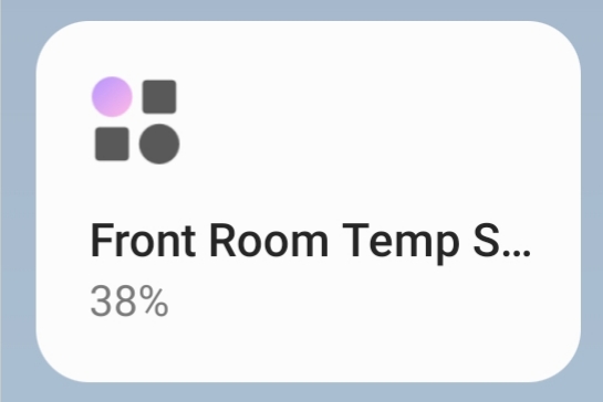

I have a few Xiaomi temp/humidity sensors set up using the following device handler, i would like the default reading on the tile to be temperature rather than humidity as shown in the tile image.
Could anyone help and advise which line i should change in device handler to do this, if it is possible?
Thank you

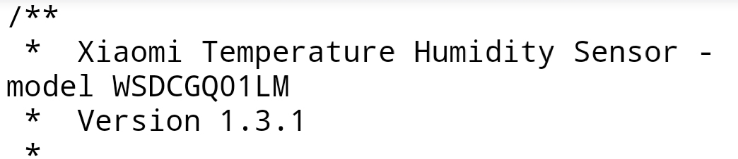

Thanks for the response, i have tried the follow DH but get the same result.
Try to change type/DTH to SmartSense Temp/Humidity Sensor. It works for me…

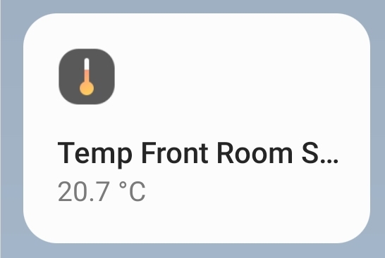

@siddys - yes, that’s the one. I just tested this with another sensor that was on the Xiaomi Aquara Temperature Humidity Sensor and switched it over. It made the change. Note that I did have to close out of the new app on my iPhone and restart it (so it goes through the whole checking status thing on all devices). At first it still showed humidity on the device list - I went into the device’s page and out and then the temp was showing on the list. It’s not as immediate as on the Classic app.
[Edit - @siddys - never mind. Apparently making the switch as I recommended previously to the non-Aqara temp/humidity sensor now breaks humidity reporting in the new app. @Neudy’s suggestion on using the SmartSense Temp/Humidity sensor seems to be your best bet for the new app (it works for me). Sorry - the switch used to work just fine!]
No joy with the alternative Xiaomi DH.
But changing to Smartsense did it.
Thank you all for your help.
Screenshot_20200329-204239_SmartThings
I’ve tried your proposal and it works fine,
Thank you
