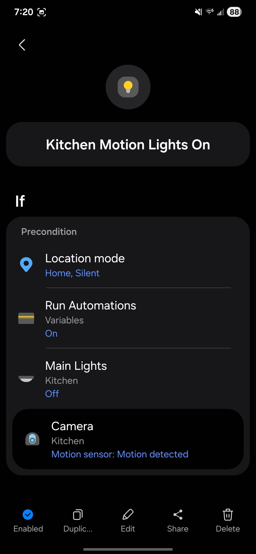

Every few days, some of my routines stop working due to some (not all) of my tapo cameras showing errors in the routines. The routines themselves show no indication of a problem within the routines tab unless I go into them. Then I just refresh the connection, and it works! What’s going on here? I’ve done this 3 times in about a week! @nayelyz

-It seems random. Different days have different cameras with the issue.
-Yes. All other routines are fine, except for the ones that have these cameras as triggers. No indication that there is a failure to the routine, like when a device is removed and the routine gets disabled.
-Different cameras have different routines. So one day, one routine stops working. I check the routine, I see the issue in the routine. I go to the linked connection, refresh, and then it works again. Another day, a new routine. Rinse and repeat.
-Yes, the time stamp is accurate for AM EST.

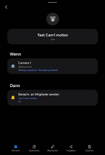

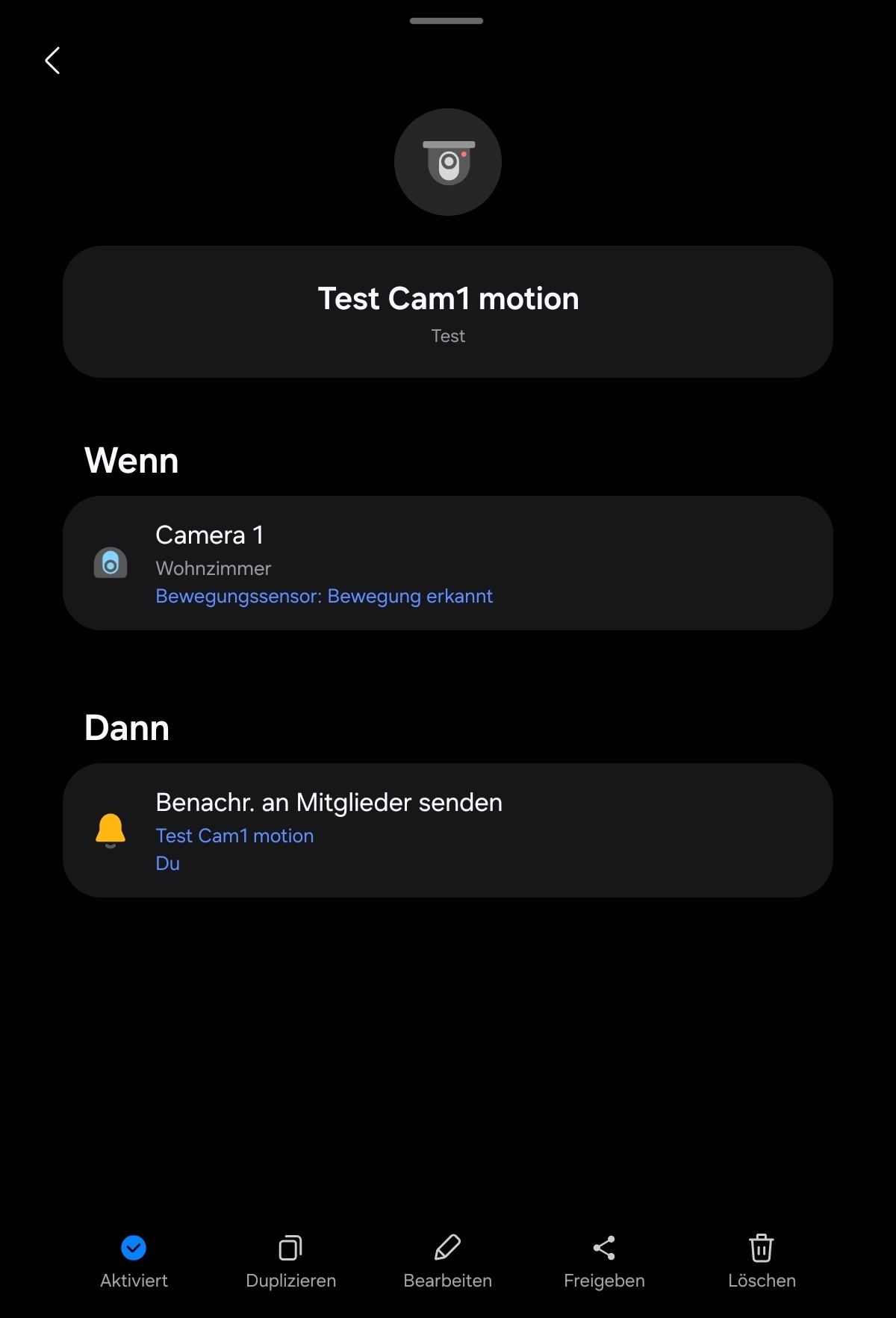

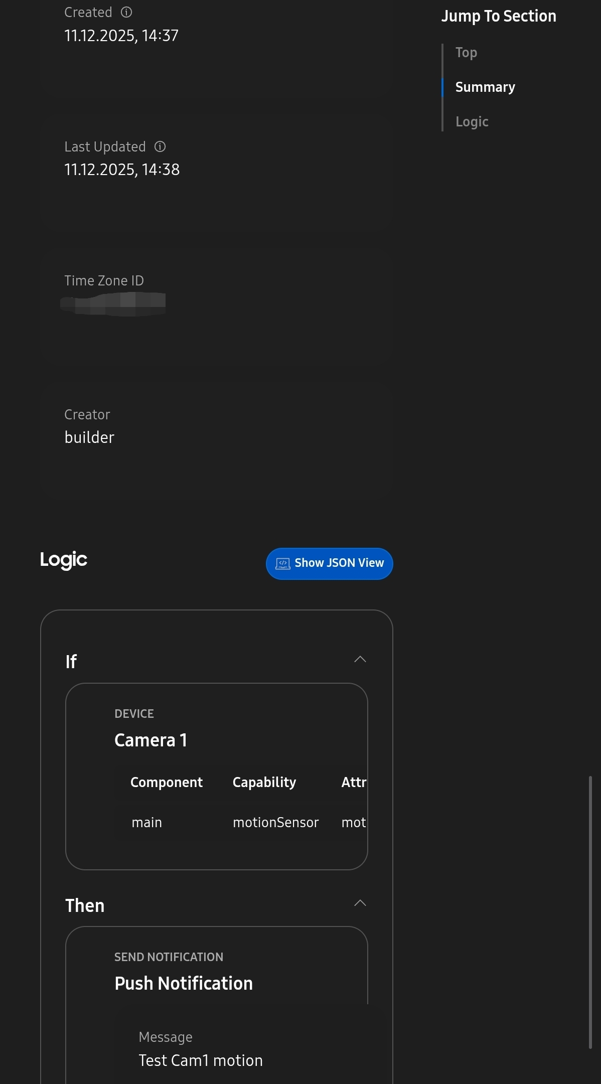

I have set up a test routine right after reading the original post:
IF Tapo C225 - motion detected
THEN Send message
No issues since I set it up four days ago.
