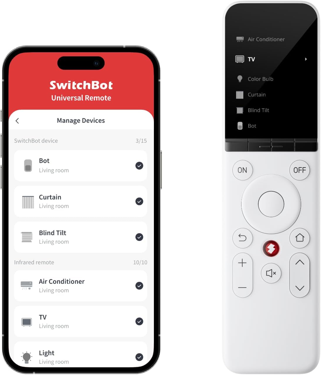

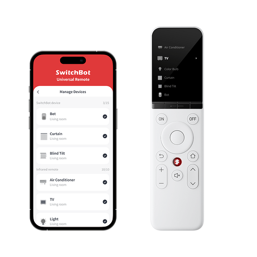

I assume we’re talking about this screenshot from their site (arrow added by me)
The individual devices are previous functionality exposing them via their matter bridge, so unrelated to the universal remote.

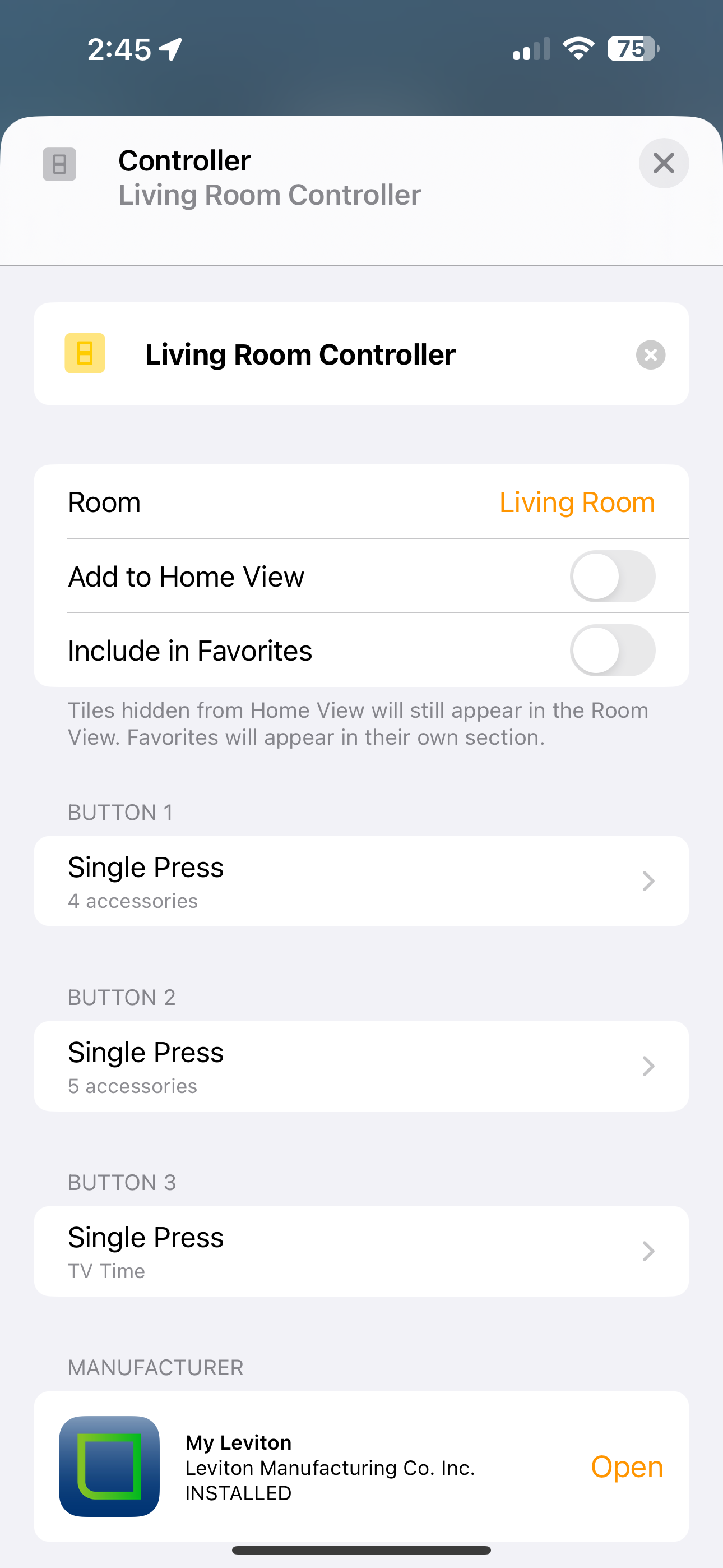

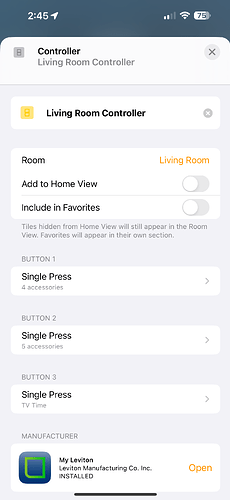

The universal remote tile has the Apple Home icon for button controller. Exact same icon is used for my Leviton Scene controller that works with Apple Home. Clicking into it this is what the settings look like.
So what SwitchBot could be doing is exposing each of the Universal Remote’s scenes as a button over their Matter Bridge. Scene activation on the remote then is mapped as a button press via Matter.
Yeah, that one, you can see the remote screen if you zoom in, the devices in Apple Home appear on the remote screen too. You can select which device you are going to control, the bulb, the curtain, the fan or the blinds.
If they’re going to expose it as just one device with buttons it’s probably going to be quite limited when it comes to control (like just on/off for instance).
Those are all SwitchBot devices. SwitchBot devices can be controlled from the remote without Matter.
Those are SwitchBot devices which can already use matter over bridge to come into other platforms.
If that’s true it’s false advertisement about the Matter control for third party devices.
Look at the picture, it depicts a feature to control any Matter device in your smart home platform, they display four different devices which are the same four in the smart home platform. If that’s not Matter but Switchbot devices controlled with their own hub, it’s just deceiving.
They even drew those blue arrows to enforce the concept that the devices that you are controlling with the remote are the ones that you have in Apple Home. If they’re not, what’s the point of that picture other than confusing potential users?
They even explicitly say (bold mine) “Through Matter. In addition to SwitchBot products, other smart home brands under Matter can also be remotely controlled, such as Philips Hue lights, IKEA curtains, and more. For a completely seamles smart home experience.”.
That light and that curtain have to be Matter products, not Switchbot.

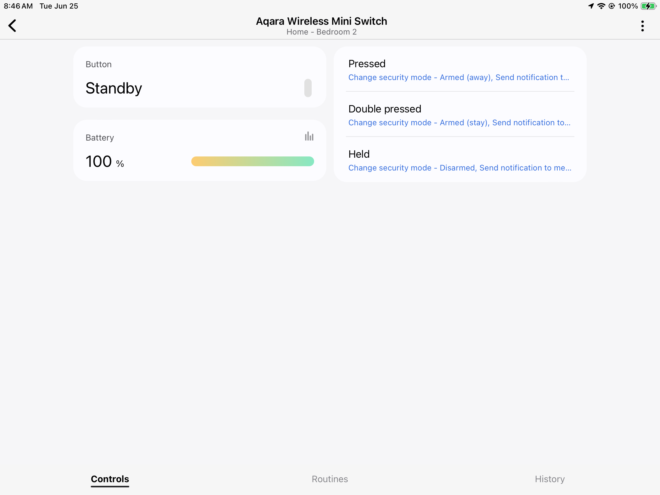

Sure, but when it’s matter over bridge, it’s up to the platform that owns the bridge to decide how the device will be exposed.
For example, my Aqara Buttons work just fine When exposed via matter over bridge because the bridge is lying and saying that they are switches.
