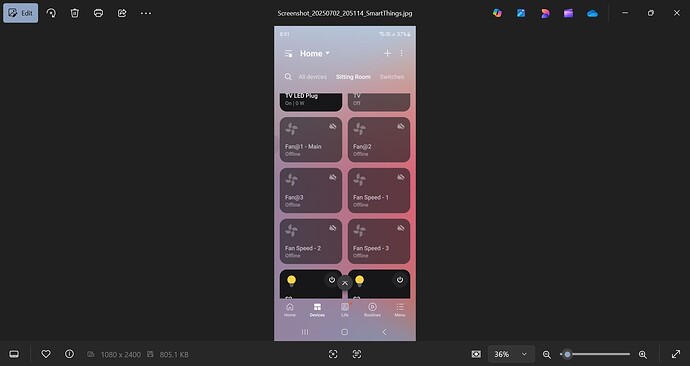

Don’t know why a video is required. Any device that is offline will show the same way as per the attached screenshot. This started from today morning around 9:30 AM UK time.

@Subramanian_Swaminat, your description made us think you had the devices online but couldn’t control them, that’s why we asked for a video. Having them marked offline is a completely different case. Having the correct and complete description of your issue is highly important for us to ask for the correct information and open a report for the engineering team.
