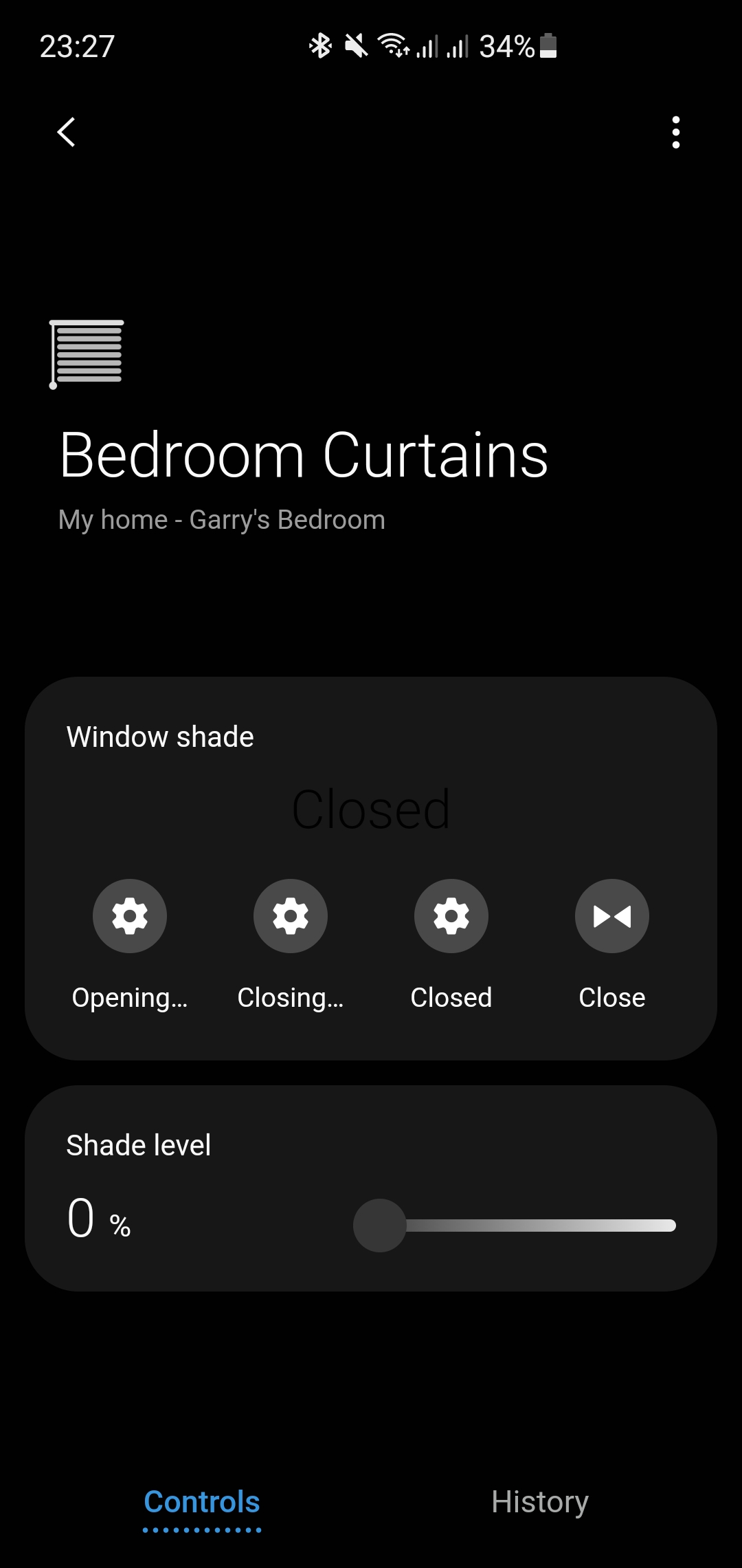

I searched and didn’t see much discussing the Switchbot Curtainbots. Finally got mine set up this weekend and they linked into Smartthings fine but the icons is backwards (shows closed when they are open, though the shade level is correct). So I’ve built backward scenes but that’s not sustainable for future bot additions. Wondering if anyone else experienced this and how they fixed it.

They said to reset the device but I’ve since added two new and they aren’t working. The Icon says/shows the wrong status but if you click into the device the shade level is correct. Also people in Switchbot FB group saying the same thing. One guy just physically switched his bits, lol. I just set up “backwards” scenes. Connected through hub.
I guess it’s still backwards, in my eyes, because 0% shade means they are providing no shade - and thus they are open yes? So it seems like they just inverted the problem?
I guess the question is what does SmartThings normally expect with curtains. I agree 0% seems wrong for closed. They do appear to have fixed the status (open/closed) but I suspect this is still wrong. If we can prove it is not correct for SmartThings I can probably get them to change it.

Indeed. The actions for the SwitchBot curtain also aren’t correct. It’s shouldn’t show opening and closing as actions. Only close and open. Here’s the Ikea shade:
I have confirmed with SwitchBot that the shade levels are correct as per SmartThings standards which are different to those in the SwitchBot app in that SmartThings is the percentage of light let through whilst SwitchBot’s app usage is the %age of shading. i.e. 100% is open in SmartThings but open would be 0% in SwitchBot. I will raise the actions point with them.
