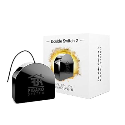

I recommend a dual relay to install in the switch box. The relay will only work if you have a neutral in the box. With a relay you can still use your existing switches.
Otherwise, you will either need to wire the lights together (so they turn on/off together) or use smart lighting. Both have their disadvantages.
Here are some popular dual relays. I do not use any of them but be sure to note the Watt/Amp requirements and their size. Some are hard to fit in existing boxes.
ZigBee dual relay:

Right now, I think @jhamstead’s solution of a micro double switch might work best.
The Leviton VRCS2 is a zwave switch with the same form factor, two switches in a single gang space, and is pretty popular in the community.
That’s a Z wave classic model. Leviton is just starting to bring out their Z wave plus models, which have a longer range and are a little easier to pair in place, if you want to wait a couple months and see if a Z wave plus version arrives. But a lot of people are using the classic version and are happy with it now so that’s up to you.
It’s an expensive switch, though, so you might rather use one of the in wall micros just to save some money. Choice is good. ![]()

I can’t speak to the specific wiring issues, but the following FAQ is about a year newer than this thread. The main difference is that the Leviton switch is no longer on the market and they have not yet come out with any replacement for it. So pretty much the only option right now is the in wall micros. There are a couple of different brands available.
