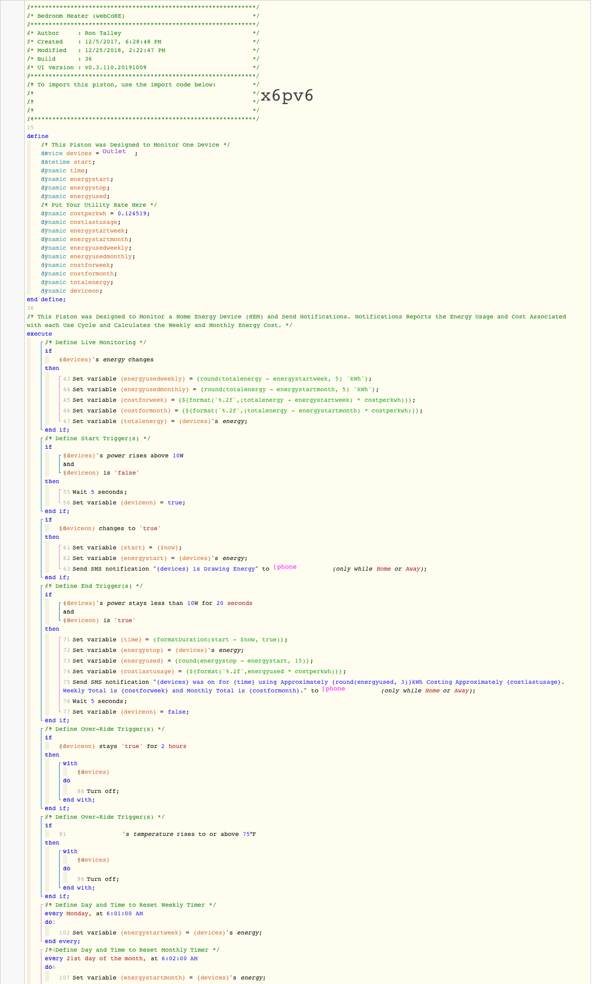

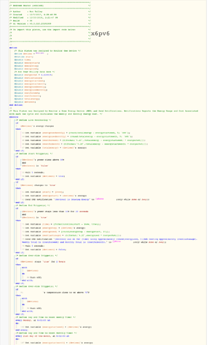

You just take the kWh and multiply by your utility rate. I have a Piston that calculates the usage and sends notifications. You can easily edit it for your likings.

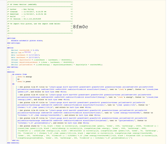

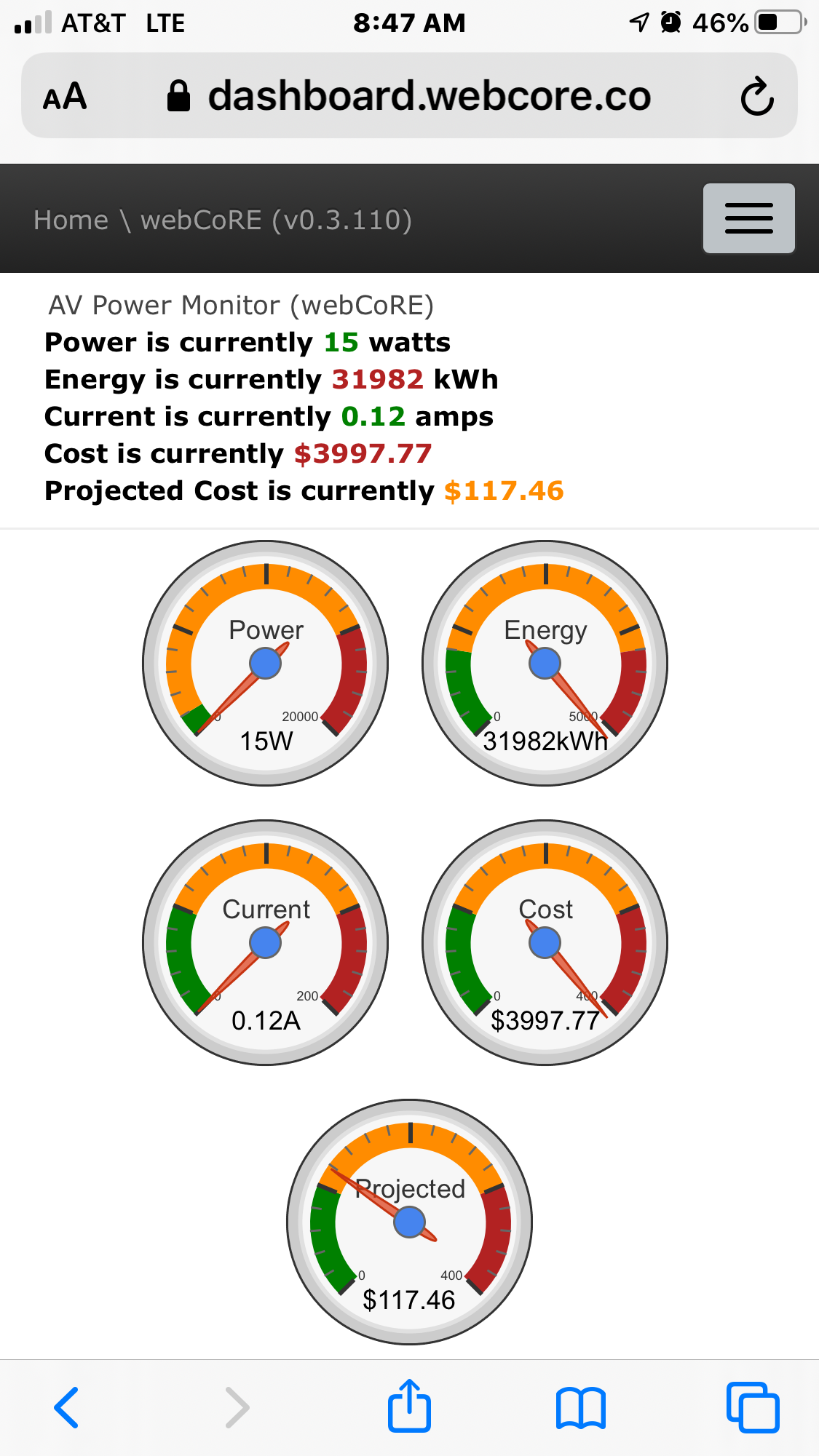

Here’s another example where it’s calculated and gives you a graphical representation on your webCoRE dashboard!
