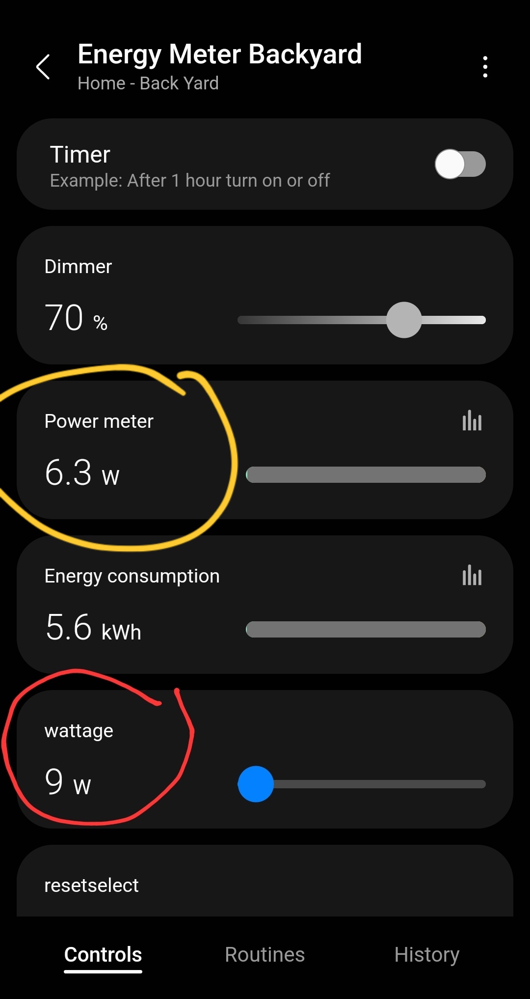

I have suggestion for virtual meter, if is possible to hide button feom Dashboard view, and instead of On or Off to show current Power usage when On, and 0W when. Meter is Off. Something like I have Photoshopped below. This would eliminate accidental switching and it will provide current Power Meter draw (circled in yellow)
From this dashboard tile
Last thing to ask, is it possible to add only one decimal point to Wattage (circled in red), as some smaller loads like bulbs or PC fans can be point something watts, like 6.5 or 12.5 etc.

Yes, this is possible: I could display the power usage instead of the switch state, and remove the button. BUT, if I did this you would lose the ability to tell if the switch is on or off because the icon color highlighting would not work. It keys off of the state being shown and if that is the power meter value, then it will always be grey. Is this acceptable? I could make this a configurable option too.
You may recall that we tried this before and at the time there was a problem with the custom capability not displaying the decimal values. I had reported the problem to SmartThings. But that was back in July and it’s possible it has been corrected, so I’ll run some tests.

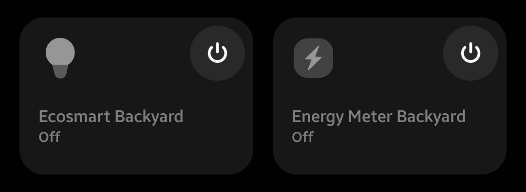

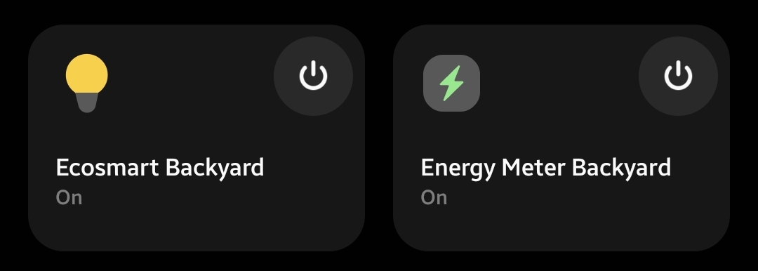

I think that icon would change between gray and color icon, and 0W for off or word Off, and any current Power Meter value for on status would be good.
This are example of On and Off status, with corresponding light bulbs

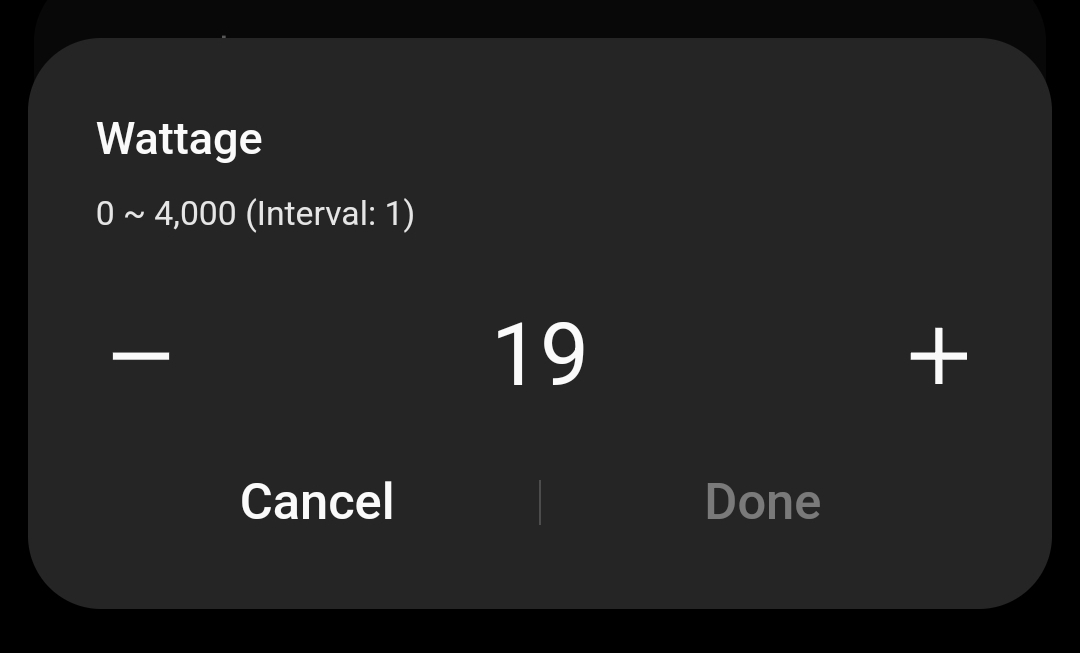

I’ll experiment with this, but it wasn’t just the display of the value, it was the ability to input. I think I will have to remove the slider control for setting the wattage if it is not an integer. So it will be just a plain input field.
I just tried it and it still seems to be a platform bug that you can’t enter decimal values in a numberField. Not sure if this is specific to iOS or not; it’s possible it works on Android.

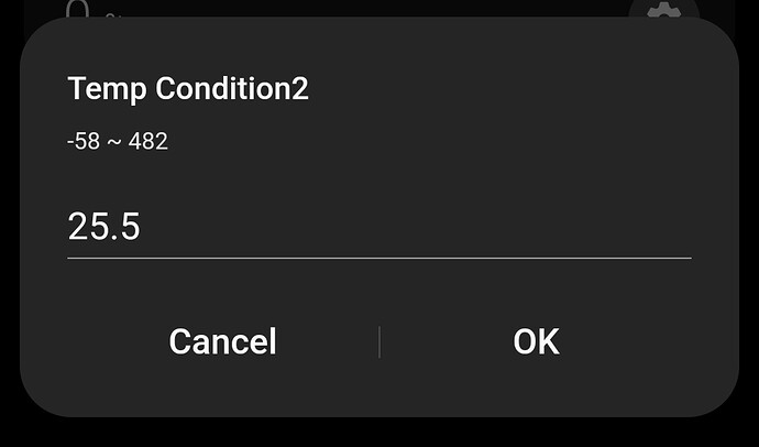

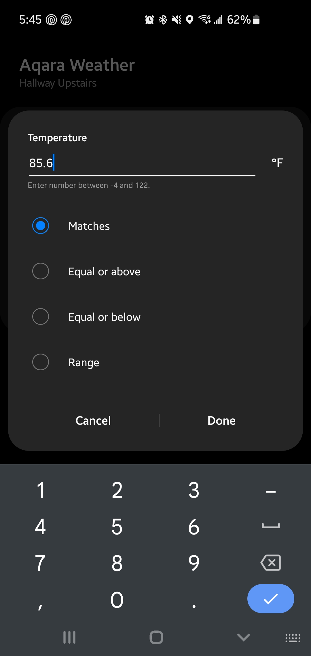

Do you have any other devices that allow you to enter a decimal value?
I don’t mean in an automation configuration. That appears to be working ok. I mean do you have any devices where you can enter a number on the Controls screen that allows you provide a decimal?
Real devices don’t have a problem because the numbers are set by the driver, not by end user. In the case of this virtual device, it needs to be entered by a user, and that’s what appears to be broken.

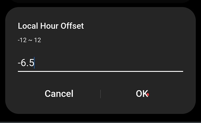

I have tried some other devices and every single one goes gray as soon as I type “.”, except Local Hour Offset in Mariano’s drivers. However even I can enter decimal value it doesn’t let me save it.

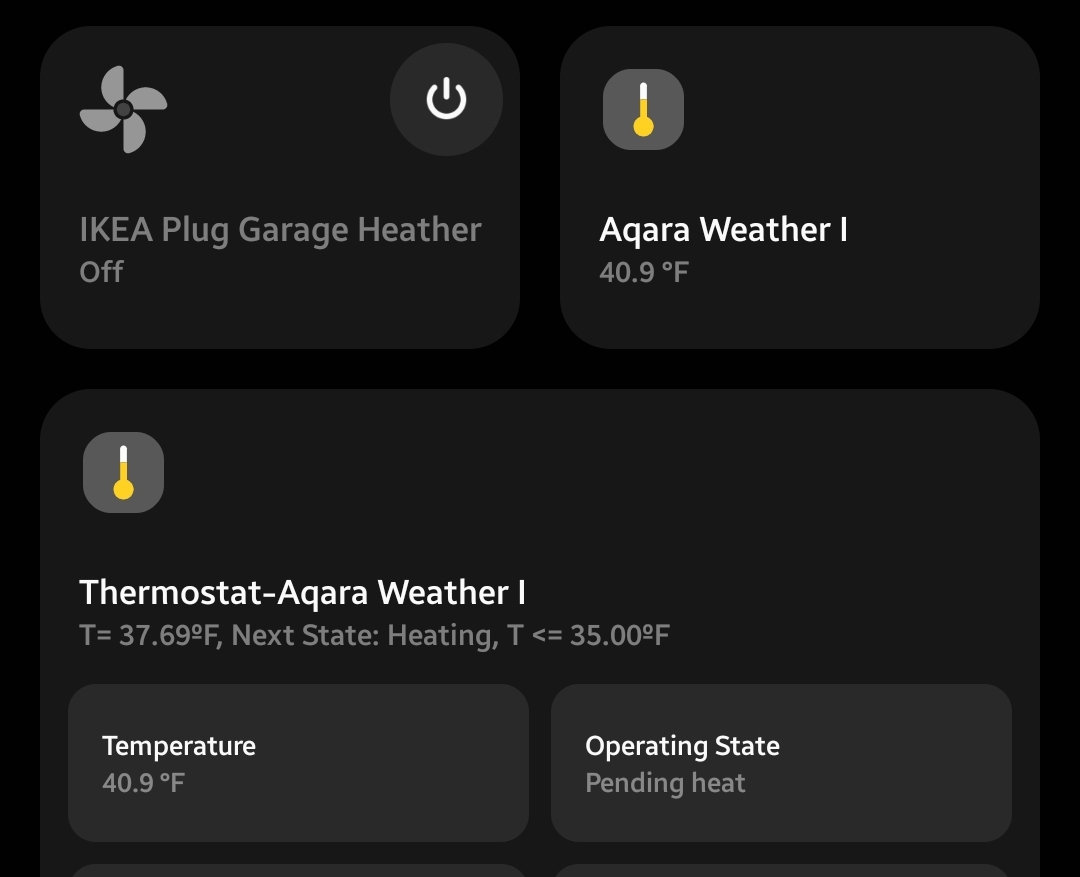

I’ve got a driver update that allows you choose from 3 options for the dashboard: switch, powerMeter, or energyMeter.
As I suspected, when showing power or energy values on the dash, the icon no longer changes with the state of the switch. It is color highlighted, not greyed out.
