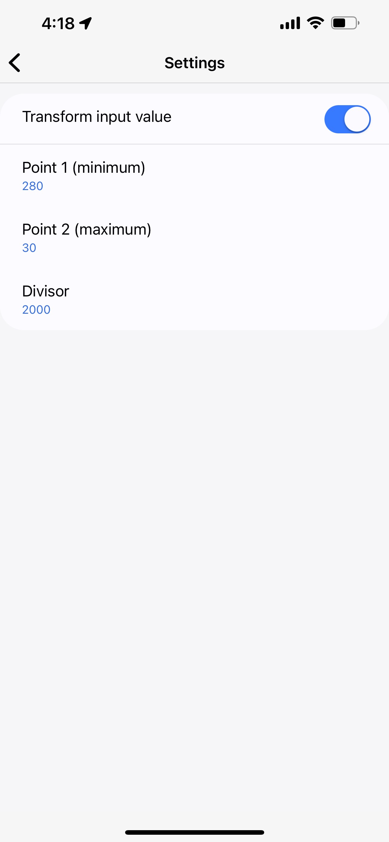

Hello @hongtat
Hope all is well on your end. I wanted to recall this idea and see possibility of implementation anytime soon.
Meaning is there a way to change the value that appears on the WebUI so we can reflect that on the ST app.
Thank you.

@fshadfan - The option to modify the actual value is available now. Go to the distance sensor settings and fill in the values.
This is the formula; ((INPUT-MIN)*DIVISOR)/(MAX-MIN)
Perfect !! It works really well. Thank you @hongtat
