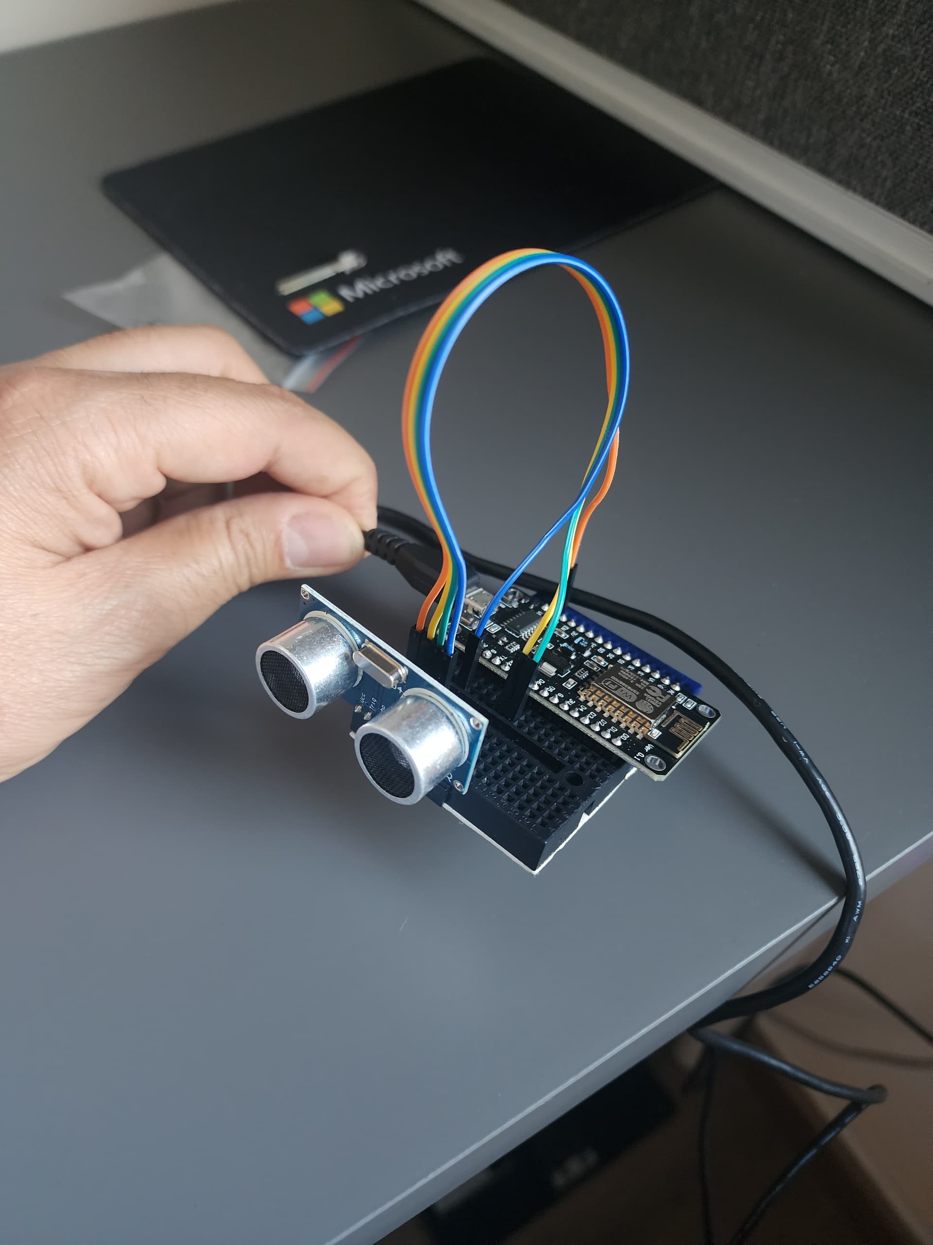

Hello @hongtat. Thank you for all the great efforts you are doing here. I have built a similar device to your post on line 526. ESP8266 w/ HC-SR04 ultrasonic senor. I will use it for a tank level application.
Now for starters on the UI it seems to work perfectly fine. It measures the distance and all is looking good. Now on the ST application, I cannot seem to be able to add the SR04 device for one reason or another.
Basically what I have done is that I added “any device” except for sensors and gave that device the same IP address as the ESP8266. Nothing happened though.
I seem to be missing something when adding this device to ST.
I would really appreciate your guidance on this. Attached some pictures for reference.
Thank you.
Yes. That’s correct. Could you check whether you have enabled “Sensor discovery” under Tasmosta Edge device settings? Once enabled, it should add the SR04 sensor within a few minutes.
If it doesn’t, can I have the output of http://<IP>/cm?cmnd=status 0
Hi @hongtat. To be honest with you I missed the “Sensor Discovery” option. Now it is working fine and displays the distance.
