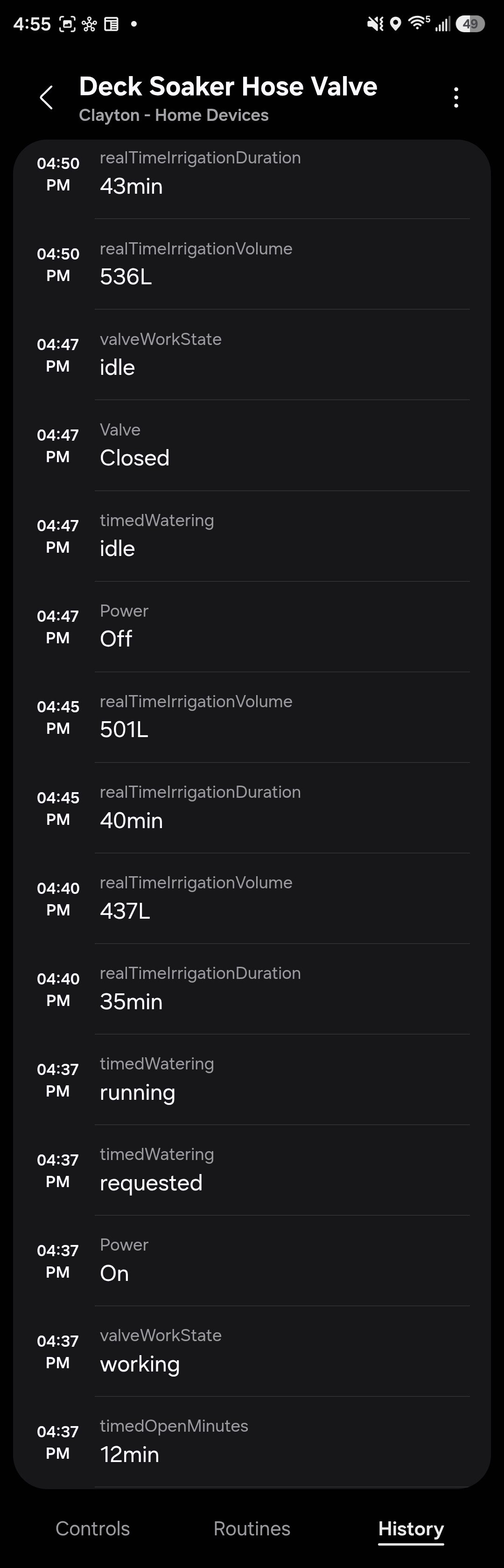

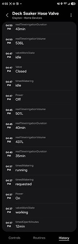

Hi @Andreas_Roedl ,
Looks like the timed watering will stop at 10 minutes again, but only if the value requested is more than 10 minutes. Anything below 10 minutes is OK. See below where I requested 12 minutes but it closed after 10.
The log at 4:37pm requested 12 minutes, and the valve closed 10 minutes later (4:47pm):

Test 3: I set the timed watering to 15 minutes. Same result. Valve was closed after 10 minutes
Is there something I missed in the configuration?
Has anyone else experienced similar issues? I
'm wondering if my unit is working properly. It keeps showing “waterSensor = dry.”
