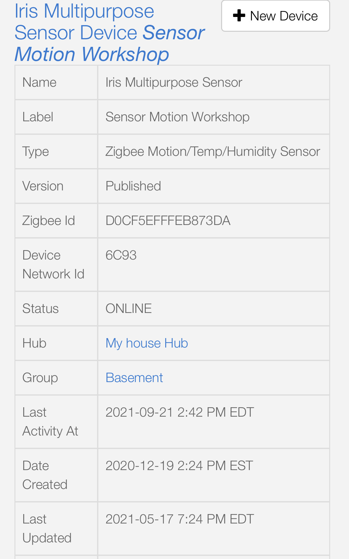

What is the Type for it in the Groovy IDE?
Zigbee Motion, temp, humidity but i had placed it on smartsence motion so it would run local
Those are Groovy device types, so it didn’t pair as an Edge device.
It did in fact pair as the ZigBee motion sensor Edge driver…
is it a V2 or V3 iris sensor? V3 is the only one that has humidity. Edge devices should show as placeholder in the Groovy IDE, so something went sideways with that sensor.
It did show as a placeholder and it is the last manufactured version. It shows humidity with the stock groovy implementation
Now I’m confused.
I think you were asking what it shows at the moment, wanting to make sure it was a placeholder and so clearly an Edge driver being used, but the answer was the DTH that was being used prior to the Edge driver. If not, I am confused too.
