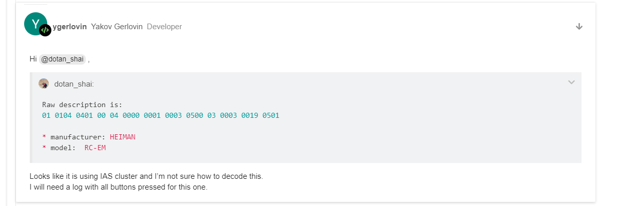

Did you manage to find an edge driver for the Model HS1RC 4 button remote ?
Not Yet …
Raw description is:
01 0104 0401 00 04 0000 0001 0003 0500 03 0003 0019 0501
Can you please generate a LOG for this device.
Please refer to what @ygerlovin requested

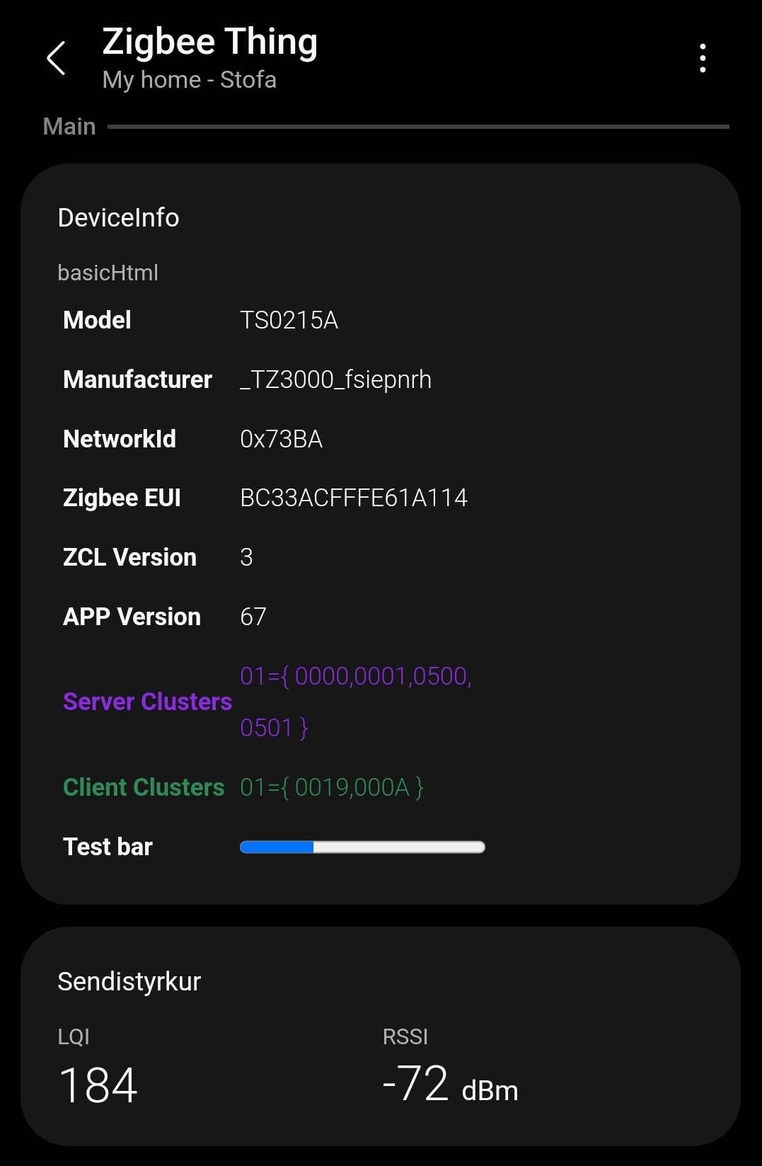

Would it be possible to add this 4 button Nedis Zigbee Remote Control (TS0215A) to this Edge driver?
ZBRC10WT_P30
I’ll try when I’m home thanks

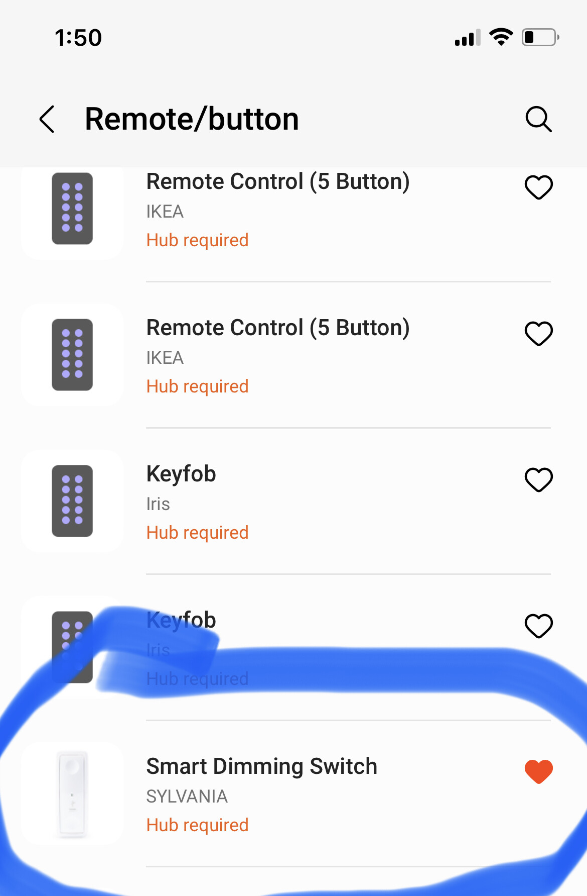

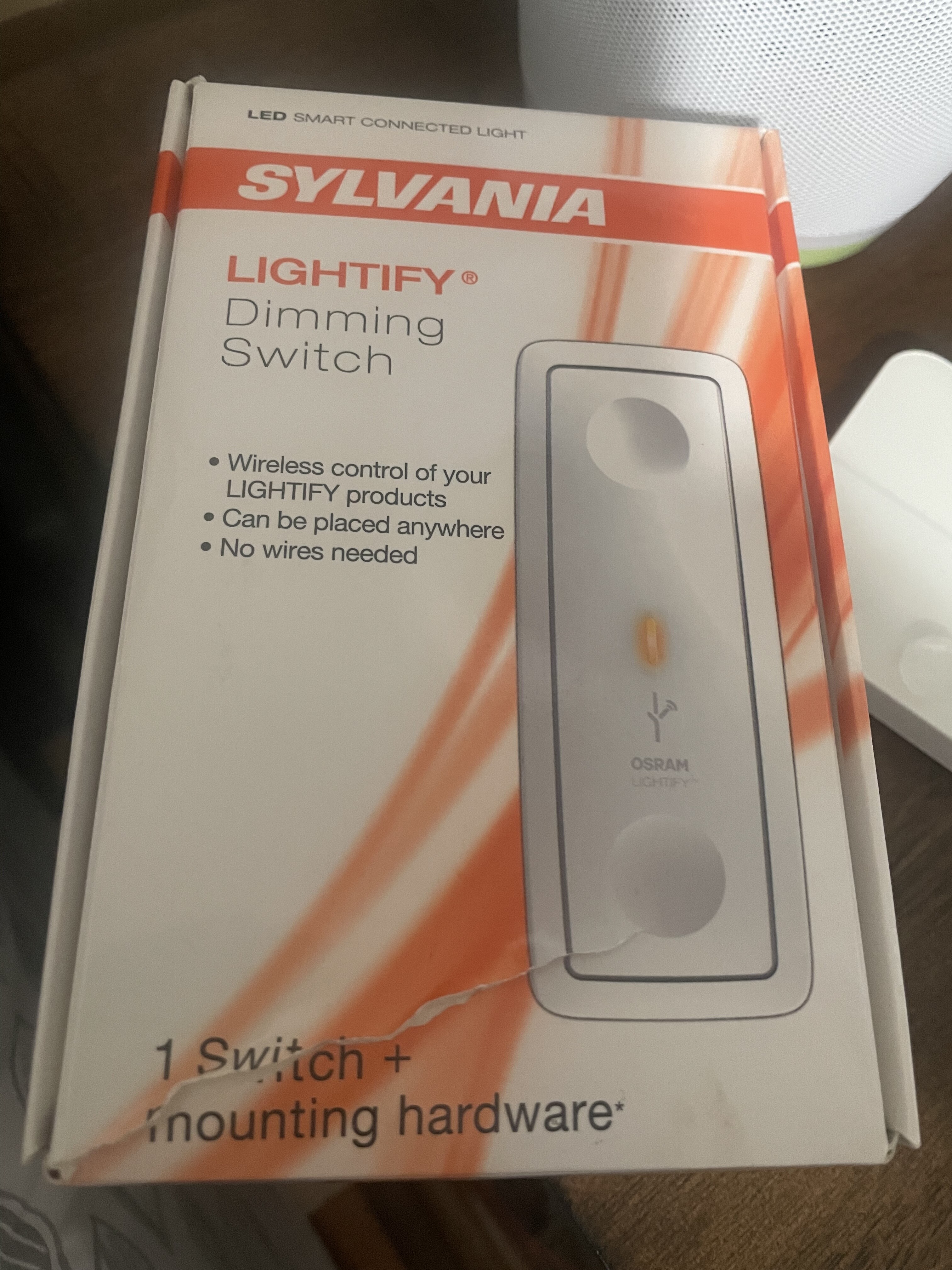

Does anybody know of a driver for the Osram/Sylvania smart dimming button switch? Smartthings says they support it but it only treats it as 1 button instead of a 2 button switch. I have 5 of these that I use for arming/disarming alarm and turning off all lights or turning on specific lights. I used to use a custom button controller and DTH and it was perfect before Edge.
