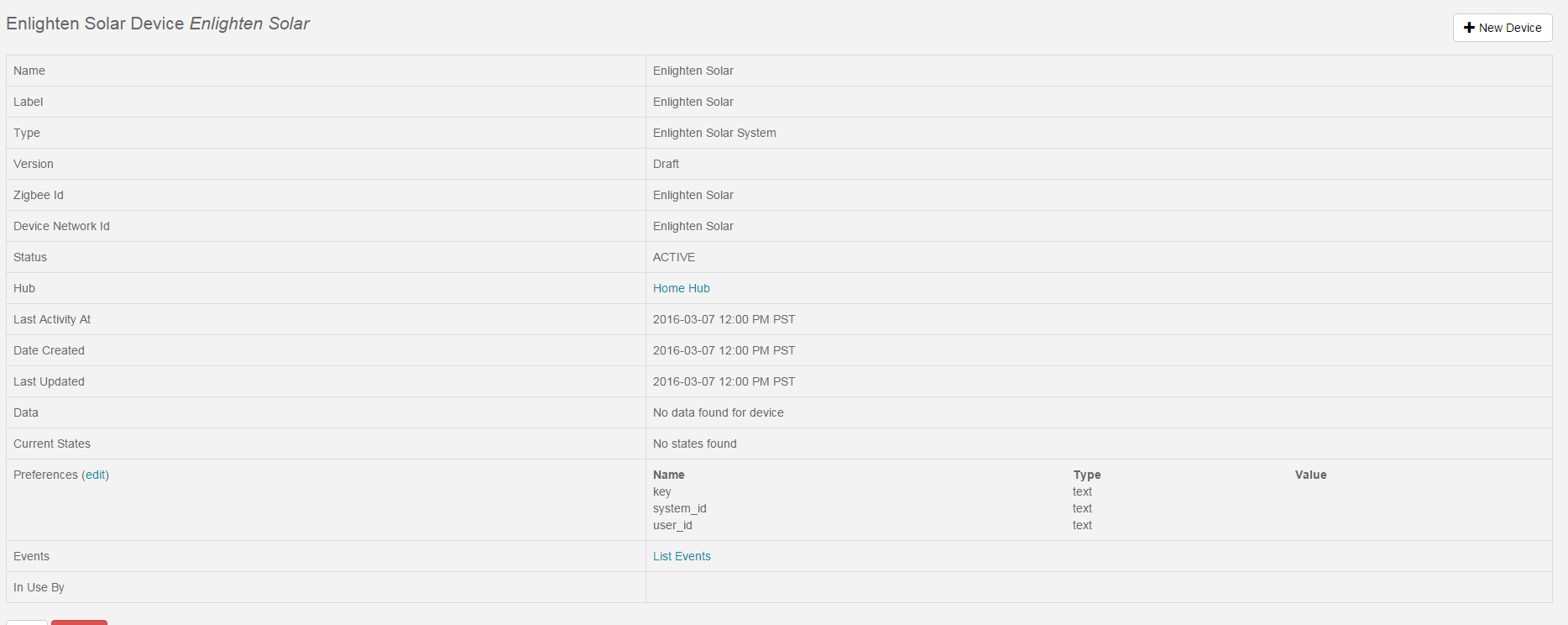

I am having difficulty adding my system to ST. I think (and hope) I am just pasting the API info in the wrong spot. Can you please take a look and advise?

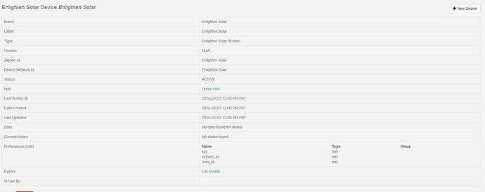

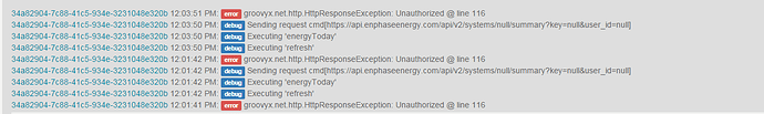

@AB4 you are not putting your preference values in correctly. Notice that the values are blank and the log says “Null”.
You just changed the “Labels” to the values. So undo that change. Past the code without changing it at all.
Then edit the device preference either in the IDE or in the android/iphone app to enter your system key, id and userid.
Bingo! That was it.
Thank you!!!

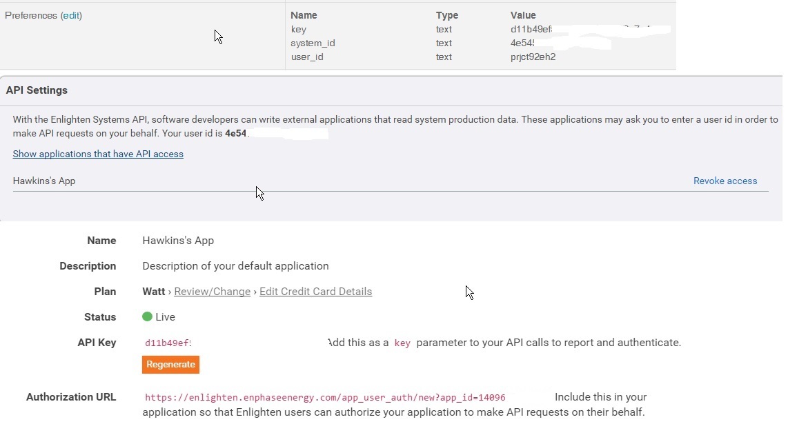

How long did it take for your api authorization to work? I added my dev api to my system and am still getting “Not authorized to access requested resource” error when testing via the html. Or did a screw something up with my setup below?
@Automated_House From your screen shot looks like you configured wrong. You API settings says your user id is 4e54XXXXXXX but you entered that value into system_id and not user_id.
looks like you used your ST community user_id as your configured user_id which is wrong. Change that to the 4e54… number and find your system id and enter that correctly.
My system id is a 6 digit number. I bet yours is also. When you login to https://enlighten.enphaseenergy.com/login your system id will be in the url after you login.
https://enlighten.enphaseenergy.com/systems/{your system id should be here}/arrays?range=today&view=energy_production
That did the trick! Thanks!
