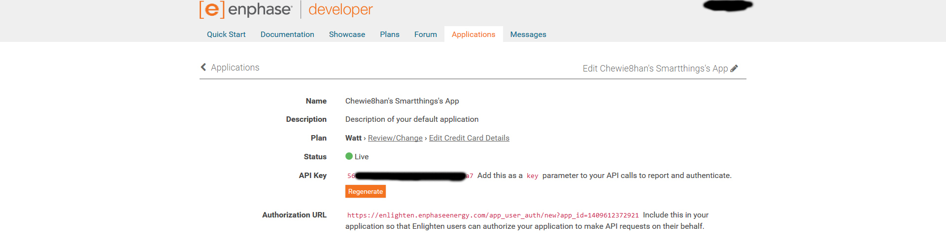

Thanks @Ron. The device is showing as InActive (but then so is yours). From the little bit that I can see from your first screenshot, I have my numbers in the correct locations. I have my API access in the account information like your second screenshot (that shows the user ID (starting with 4d). That page doesn’t show my developer key though. I signed up for that from https://developer.enphase.com/ and get it from the Applications page. It looks as long as the number you listed next to key.

This is my first time having to use a Dev account though. Other apps that I’ve used have never needed me to have a Dev account/key. I’ve only needed my user ID and system ID from the Enphase Account page. I’m guessing it might be something with that. My Dev key is the one that’s given for MY app (which doesn’t exist). I’m actually wondering if it should be the API key for YOUR app. Just a thought. Do you know of anyone else using your Device? If so, clearly I’m wrong. If not, maybe I’m right. It’s your call on if you want to share that.

You mention that you don’t see the app key you created in your account. This means you didn’t tie the app key to your system. I think that is why things aren’t working. Check out the api documentation. You can test if you app key is working by just hitting the url in a browser and seeing if you get json back.
https://api.enphaseenergy.com/api/v2/systems/{YOUR SYSTEM ID}/summary?key={YOUR API KEY}&user_id={YOUR USER ID}”
