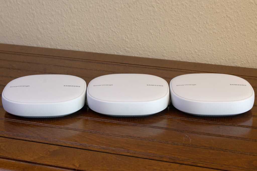

Courtesy of my ISP I had the chance to test my hub capabilities when without internet. Most of my devices are with edge drivers, so I thought most of my automations would work fine, but I was wrong. Even automations with the little house next to the title didn’t work because many of the devices (zigbee or zwave) were offline.
I noticed that the devices that were offline have as parent device one of the secondary hubs which led me to believe that only the devices connected to the primary hub will work offline as this is the hub with the edge driver installed.
Does anyone else with a Smartthings Wifi Mesh Router notice something similar? Do I’m missing something?

That would make sense to me because the Samsung Wi-Fi mesh routers are one of the few Wi-Fi mesh models currently being sold where the Wi-Fi mesh itself only works when there is an active Internet connection. (Eero originally worked that way, but released an update a few years ago so that their Wi-Fi mesh now will work without the Internet.)
So, since the primary hub cannot communicate with the secondary without the Internet, it doesn’t surprise me if “local“ devices based on the secondary fail. But I don’t know for sure. :thinking:

They are zigbee and zwave repeaters, but apparently repeaters without an edge driver and therefore, repeaters that don’t work when the internet goes down.
Sorry if I was confusing.
They are only repeaters as far as Zigbee and z Wave.
But they are secondaries as far as the Wi-Fi mesh, where one is designated as the primary. So that’s what I was referring to. I probably should’ve called them “satellites“ to be clearer.

I don’t understand the OP’s comment about the devices on secondary hub being offline. There is only one Z-Wave/Zigbee hub in the Wi-Fi mesh version, so all Z-Wave/Zigbee devices should be homed to it. Only Wi-Fi devices show as “homed” to secondary hubs, so I’m not sure how he would determine that Z-Wave devices were homed to a secondary hub. When I query the ST CLI or the API Browser+, all my devices show their Parent as the same device ID.
In general, all devices will show offline when the Internet is down because the app, the CLI, and the API Browser+ rely on the API for status and the hub can’t report device status when it’s disconnected from the Cloud.
Additionally, the second generation of the Wi-Fi mesh products used the plume cloud to route traffic between the primary Wi-Fi hub and the satellites. So the Wi-Fi mesh itself doesn’t work when there’s no Internet access.
As far as whether there’s still a Z wave connection without the Internet between the primary and a secondary, I honestly don’t know, but I thought the primary itself basically doesn’t do anything when it can’t reach Plume. Maybe I’m wrong on that. It’s a very unusual architecture. :thinking:
